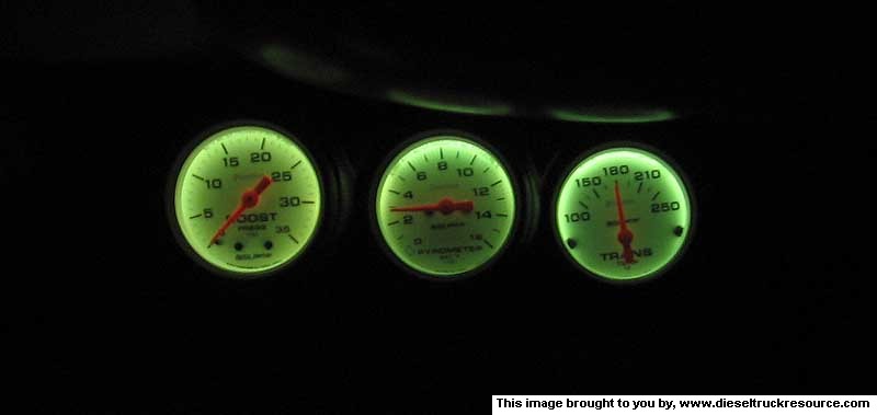

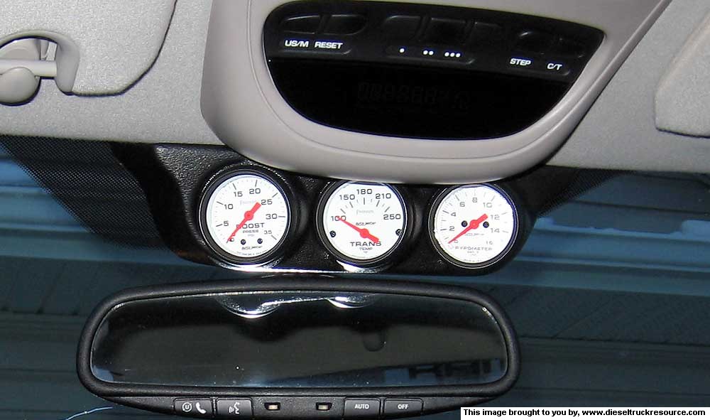

I haven't ordered from them, I bought my Autometer gauges and 3 pod from my dealership and let them do the install (thinking warranty) all for $650 installed....they even dim with the lights...
