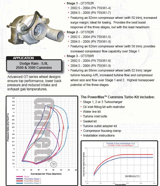

theres an article in tdr on this.
they used a gt3788r (stage3)to replace a sps 62/14. they made alot more power, lower egt and it spooled quicker, acording to piers, 550hp @1200 degrees would be no problem with this turbo.

so in reality the stage 3 is bigger than a 64, but spools quicker than a 62.
the ball bearings reduce friction to the point that you can hear it wistle at idle.
me personaly, ill be going with ether this or a 40 series come spring time. add a set of sticks and the 230 hp software, i shuld be able to hit 600.... i hope.
