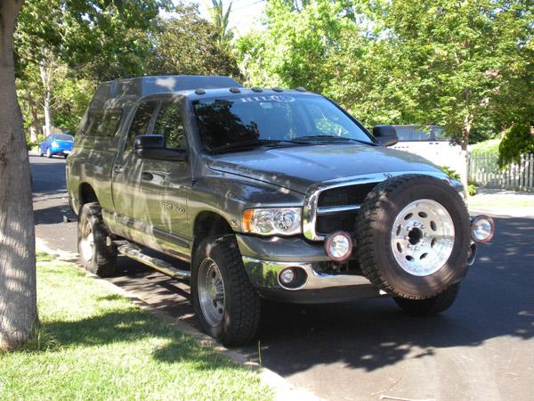

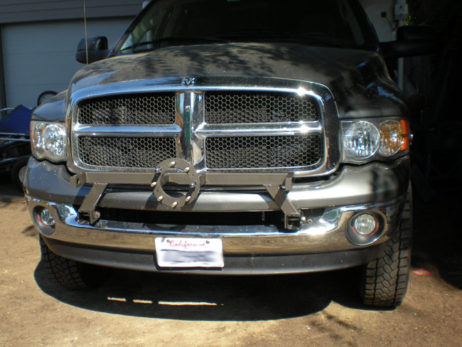

I was looking for a similar front hitch but coulndn't find one I liked... so I decided to make a pair of 2" receivers that replace both of my stock tow hooks. Now I have the option to mount a trailer ball or receiver shackle adapter and I am planning to fab up a beefy front cargo tray that slips into the receivers. My front spare tire mount also fastens to them.
Here are a few pic's...
Cheers
Mark
