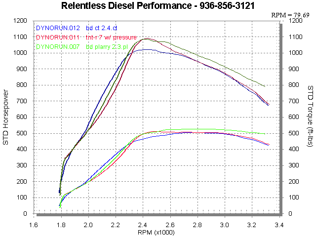

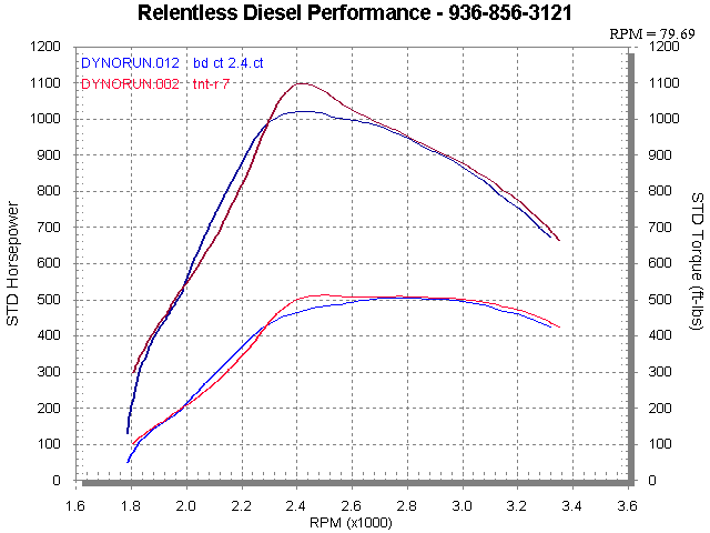

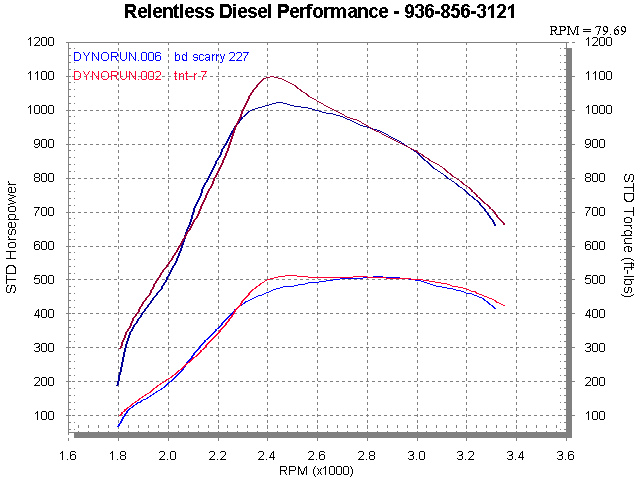

Dyno Sheets Bullydog vs Smarty
Here they are. Sorry it took so long, been super busy and have had computer problems.
Attached Thumbnails Dyno Sheets Bullydog vs Smarty-ctvstntr.gif   Dyno Sheets Bullydog vs Smarty-scaryvsct.gif   Dyno Sheets Bullydog vs Smarty-tntrvsscary.gif   Dyno Sheets Bullydog vs Smarty-plarryvsctvstntrpressure.gif

highrpms's Avatar
Posts: 223
Interesting, the Ped Larry program makes more power than the TNT. Very similar graph between the TNT and the PLarry.

Jason_K's Avatar
Posts: 761
From: Central Pennsylvania
anyway you look at it, you should be pretty happy w/ those numbers. especially with having just a turbo and programmer.
it's very nice to see a comparision between bd and smarty
Yes, but pedifile larry hit 26900 on rail pressure and the smarty hit 24k. We used the pressure from smarty for this run and it doesn't add anything on the dyno. I have another sheet that compares the pedifile larry against the tnt/r stacked with a dr p in which the smarty beat pedifile larry by .6hp and 20 or so ftlbs of torque so they are VERY comparable. I will post that sheet to show the difference tomorrow.
