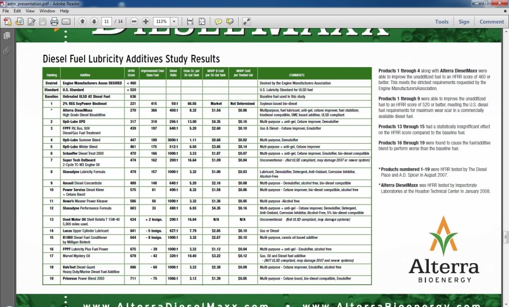

Originally Posted by mopardamo
Hello TCURAM. What test report can I find that in? Might you have a link? Thanks. Damon
The lower the HFRR number, the better.
