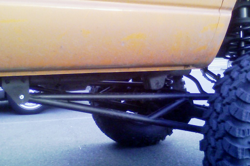

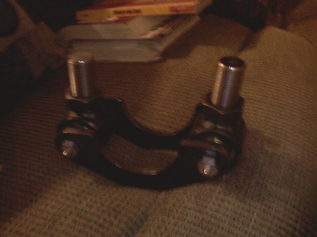

I do, frame mounts that bolt on, rear axle mounts that weld on, all with
1 1/8" rebuildable super joint. the rears are pictured there, thats just the axle mount setup, the arms will look something like those in the first pic.
