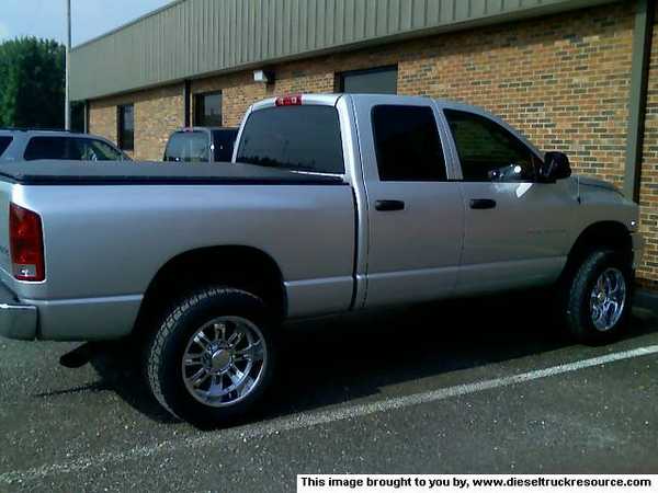

I'm running 20x10's w/ 305/55/20 nittos that are E rated. They are 33" tall, so my speedo isn't too far off. I had it recalibrated at the dealer not long ago, so it's dead on now.
The only issues you will come across are the lack of choices on backspacing on the 20" wheels. No matter what you get, they are probably going to hang out of the fender quite a bit. You will have to run a leveling kit, even with 33's. There are quite a few threads here with pics of 20's on 3/4 tons. Just search for "20* wheel" and that should bring them up.

I was thinking about going to a 275/50/20, how do you think that would look?
mtedwards...NICE LOOKING truck!

I bought those wheels and tires from Brian. I have a 2" leveling kit on the front and it rubbed the fenders a bit before I clearanced them. I'm sure 35's wouldn't fit unless you put a 4" lift on.
The Terra Grapplers are good tires, they are very quiet and seem to be wearing well. I don't think they will last much over 30K, but others have had them last longer. I guess it depends on how much towing you do with them. These tires are perfect on the 10" wheels, I wouldn't have done anything different.

LCH-I graduated from TTU. Unless you want to put a 4" lift on your truck you should go ahead with the 33's. Unless your getting something narrower than a 305. If you put some longer control arms in the front to re-center the axle more forward, they would clear better also.
snowmanx- If you went with a narrower tire, they would clear fine. Mine only hit on the outside edge of the tire against the outside edge of the fender. If the wheel had one more inch of backspacing these wouldn't have hit at all.
