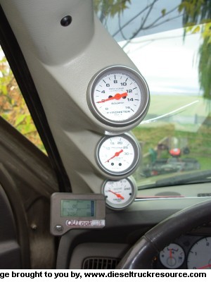

Wanting to start my first upgrades(egt,fuel,trans,boost).What do yall think about just using a commander?I dont plan on bombing but I do plan on adding a smarty in a couple months. I like the idea of having the control that the commander seems to offer but would like to hear from someone with experiance.

Analog Guages. I had both in my 05 analog and outlook and my outlook was just going off what the ECM was reading and the analog was hardwired into the truck. My boost was always way off from the two and my analog was tapped into my uuh yeah that thing I went blank!! Elbow thinggyy... Damngggg it!! I trust the analog more.. Plus if you have an auto you can monitor it's temps..

It reads real time. The only digital gauges that have problems use the OBD ports.
Also something to keep in mind is that mechanical gauges are not accurate at all. Just call the manufacturer of any mechanical gauge and ask them what their accuracy is based on the entire sweep range of the gauge. They are very poor.
With digital stuff you can read down to 1 deg increments on your pyro. The best mechanical gauges are about 25 degrees. Also many of them have a lot of trouble trying to compensate the readings for the sweep of the stepper motors.

I'm debating this myself right now, but think I'm going to go with analog gauges, you don't really have to "read" them, just a quick glance and you know where you're at.
If one analog goes wonky, you get 1 new one, the digital things seem more likely to have problems, and when that happens what do you do with it?
I guess if you liked the digital gauges of some of the cars from the late 80's you'll get the digitals, I prefer the traditional analogs though... (er, I think)
