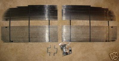

i am looking to buy a billet for my truck and i don't know if this is the right one or not.
i need to know if this is all of the mounting hardware? would love if someone could help me out FAST.

That looks like the right one. I installed one just like it in my 04 QC. I had to use some tie straps on it, it kept coming loose on rougher roads because the hardware I had did not fit exactly right. They have screws with washers that are supposed to hold the top sections in place, you slide the whole grill piece and tighten the washer/ screw against it. Not perfect, but it works and they look **** good when you get it done. EST install time...about 1 hour if you take your time. Dont be afraid to use some of your own hardware and fab anything up to make it good and tight. I had to occasionally take my ign key when walking in front of the truck and kind of give it a "shove" back in place. Hope this helps, post a pic when you are done....

Ditto on the mickey mouse screws that it comes with, they do come loose so keep an eye on it. Or go to the hardware store and buy some small machine screws or bolts with nylock nuts and use them instead of the screws. They will not come loose.

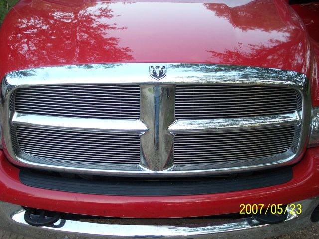

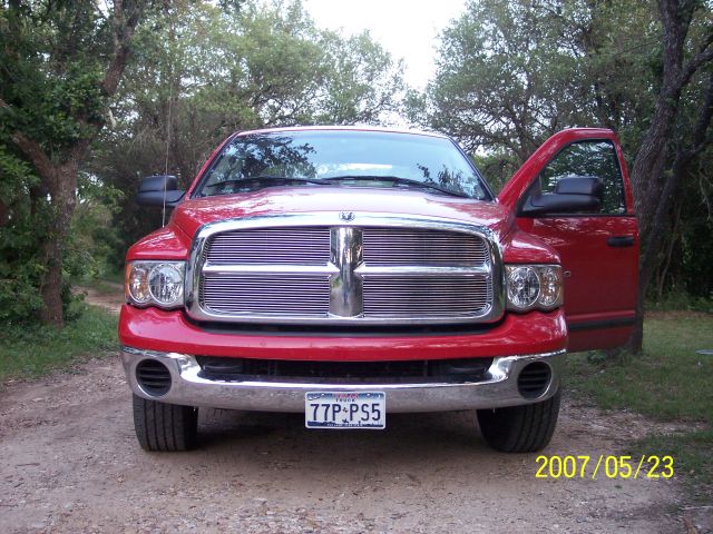

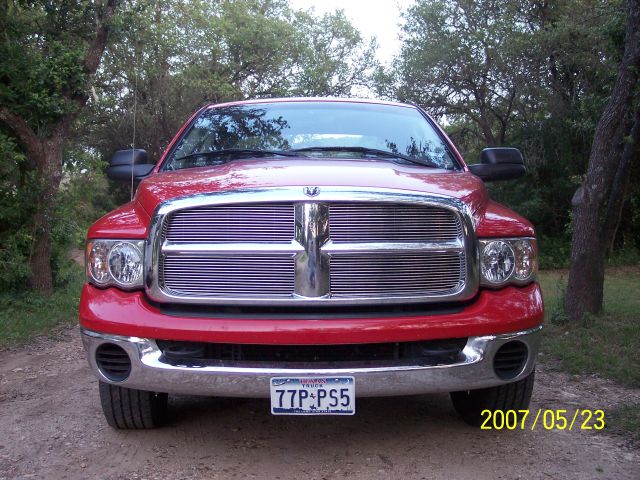

put it on last night. it was a pain in the you know what...... but i got it, thanks for all the help.
what do you guys think?

looks sharp IMO

What brand and style is this insert? Is this a total replace or a bolt on? Looks great. This is what I am looking for. Thanks.

Not sure what brand but it is metal not plastic like some of the cheap ones. i got it off ebay for $91 shipped i will pm you the link the guy had two of them. and it is a bolt on you remove you plastic one and screw the new one on from the inside. it came with mounting brackets and screws.
