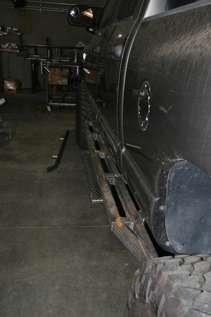

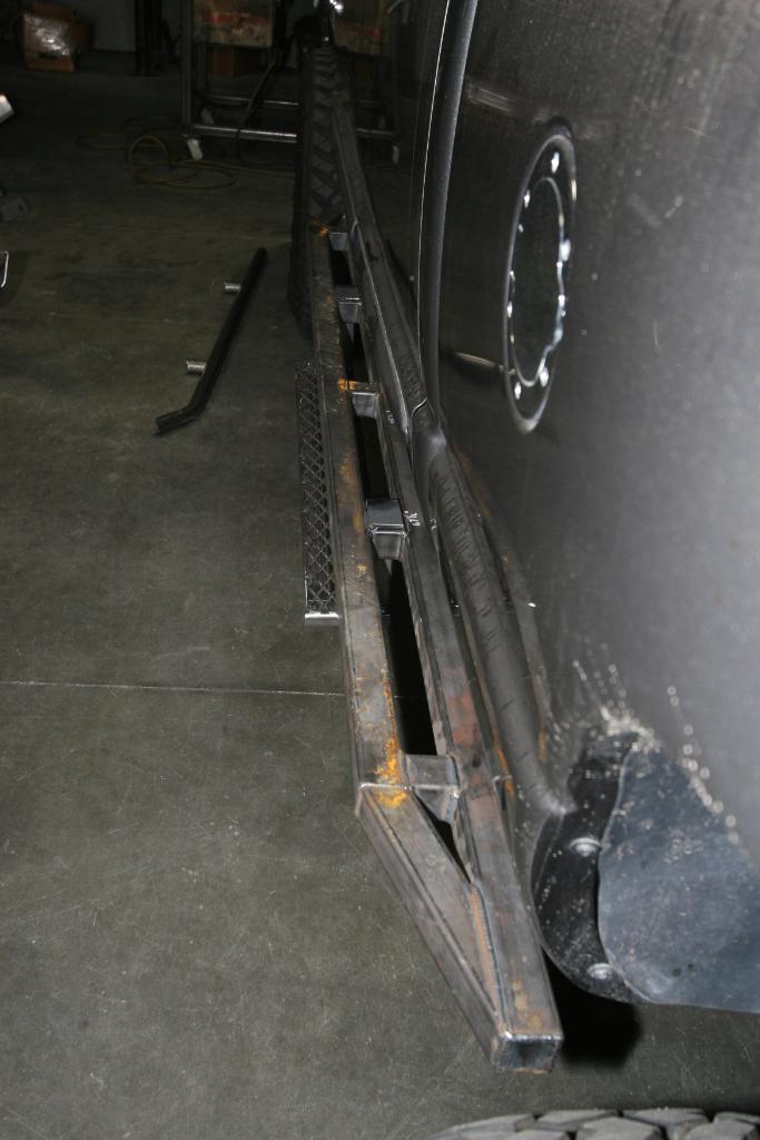

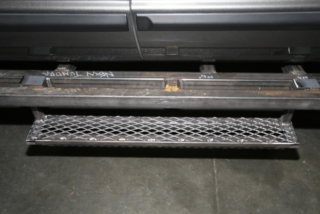

I have been searching for rock rails/sliders for 3 years now, since Dodge stopped manufacturing the Mopar Rock Rails. I received various tips on how to make them utilizing semi custom and pre fabricated products, and have even taken my truck to Paul Fox at Orange Muffler to design such a product to no avail.
I turned to Jason Demello in Riverside and he is making me these rock sliders capable of being a jacking point, that are attached to the frame. The following are photos of it in design phase.

They look very nice. Shoot some good pics of the mounting system. I am wondering how they can make the system so rigid to be able to lift the truck and not pivot into the rocker panel.

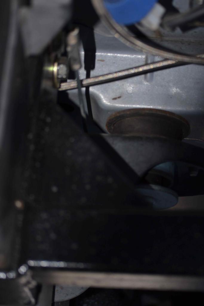

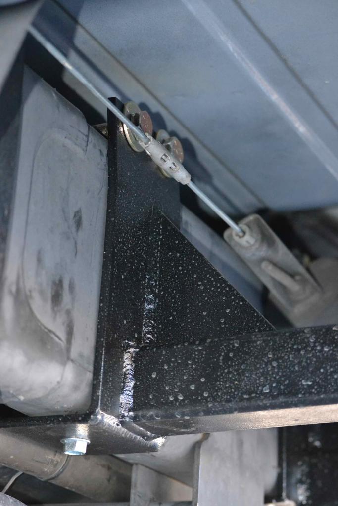

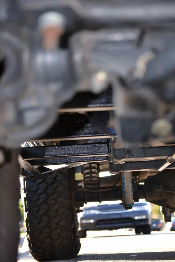

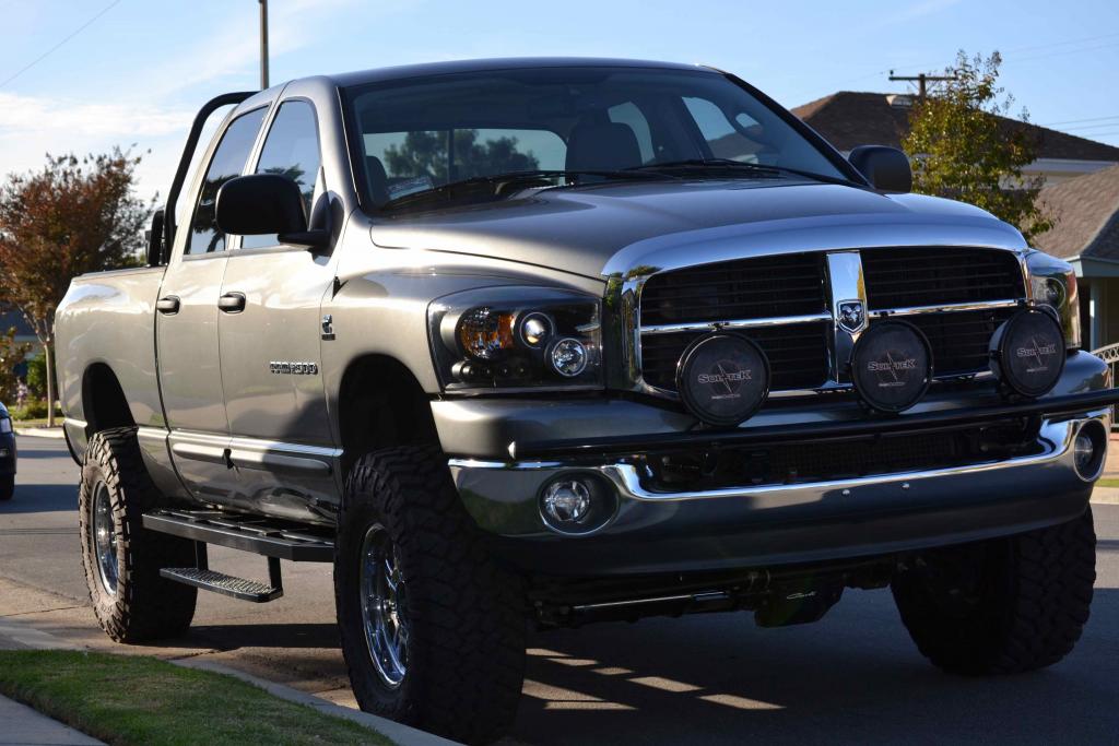

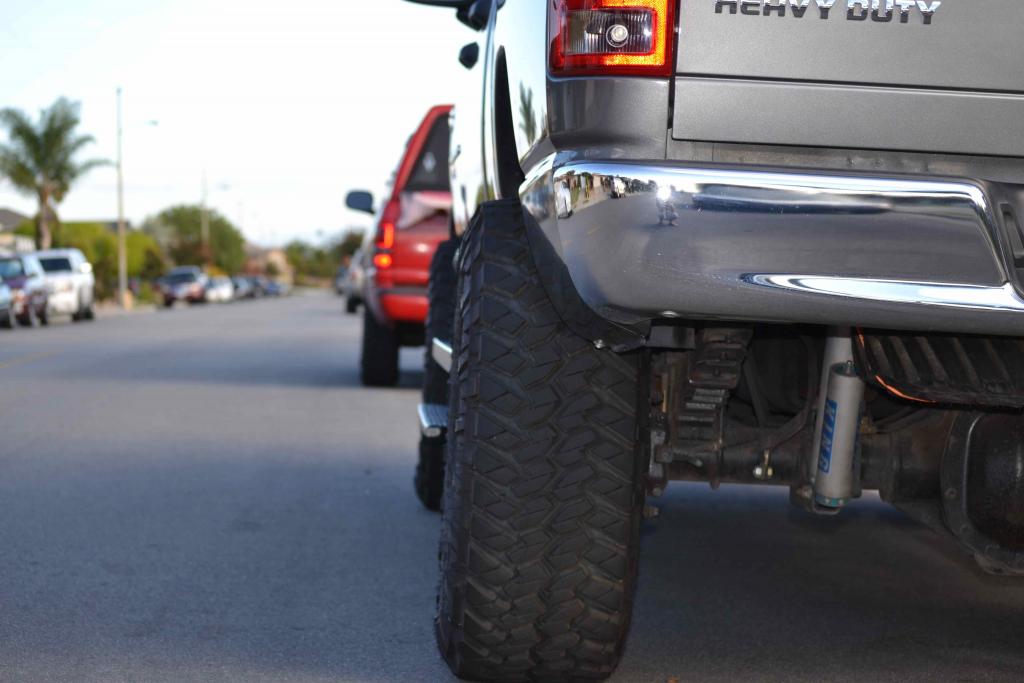

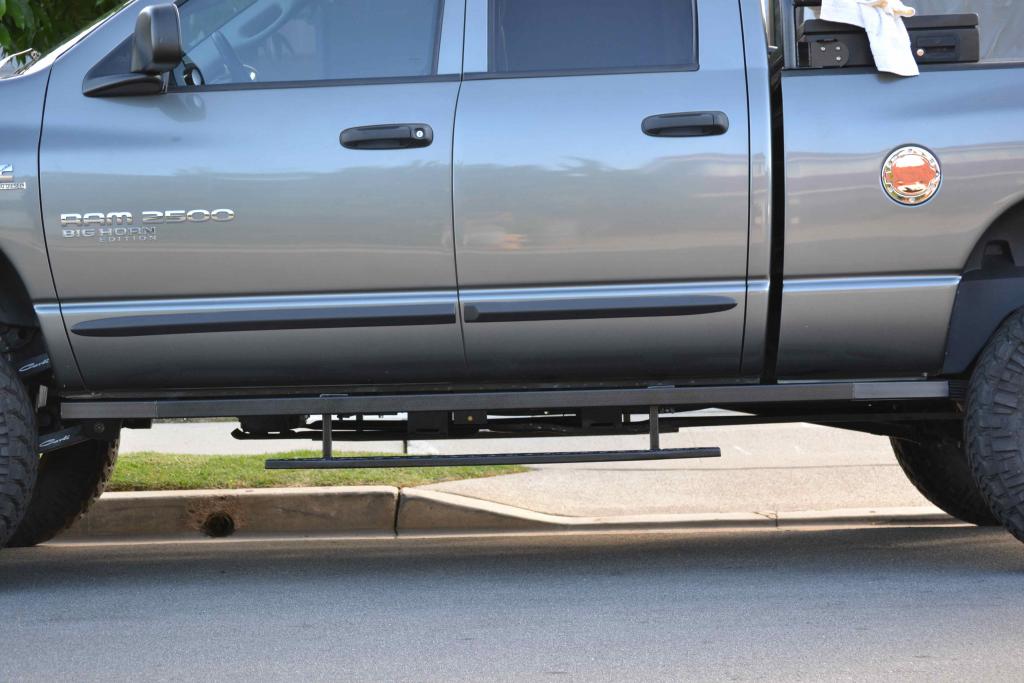

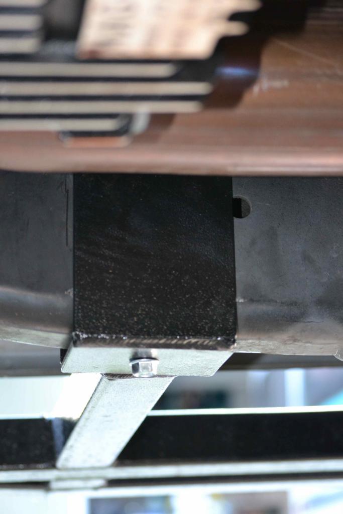

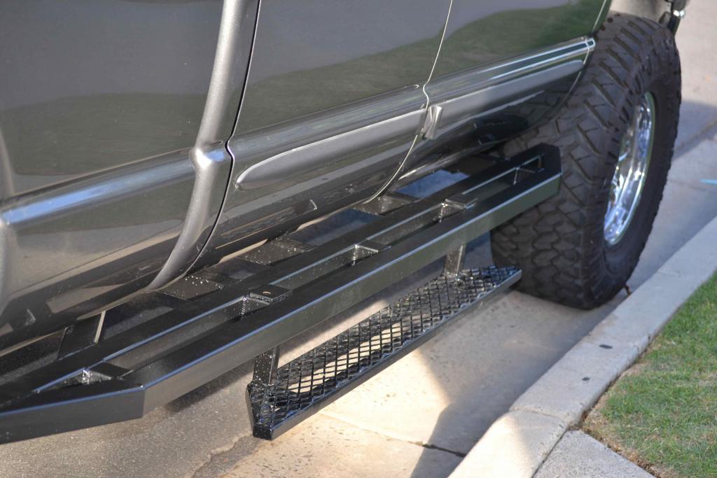

Sorry for delay of pictures but weather permitting here are pictures of the rock rails:
Attached Thumbnails Been searching 3 years for Rock Rails/Steps-dsc_0578.jpg   Been searching 3 years for Rock Rails/Steps-dsc_0579.jpg   Been searching 3 years for Rock Rails/Steps-dsc_0581.jpg   Been searching 3 years for Rock Rails/Steps-dsc_0582.jpg   Been searching 3 years for Rock Rails/Steps-dsc_0583.jpg

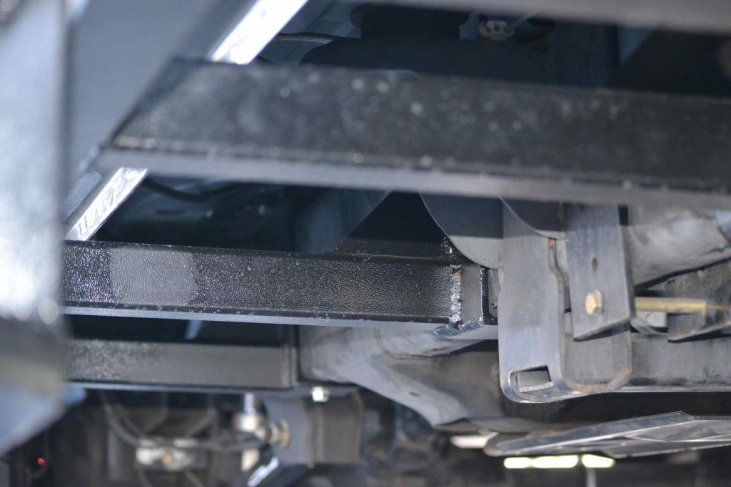

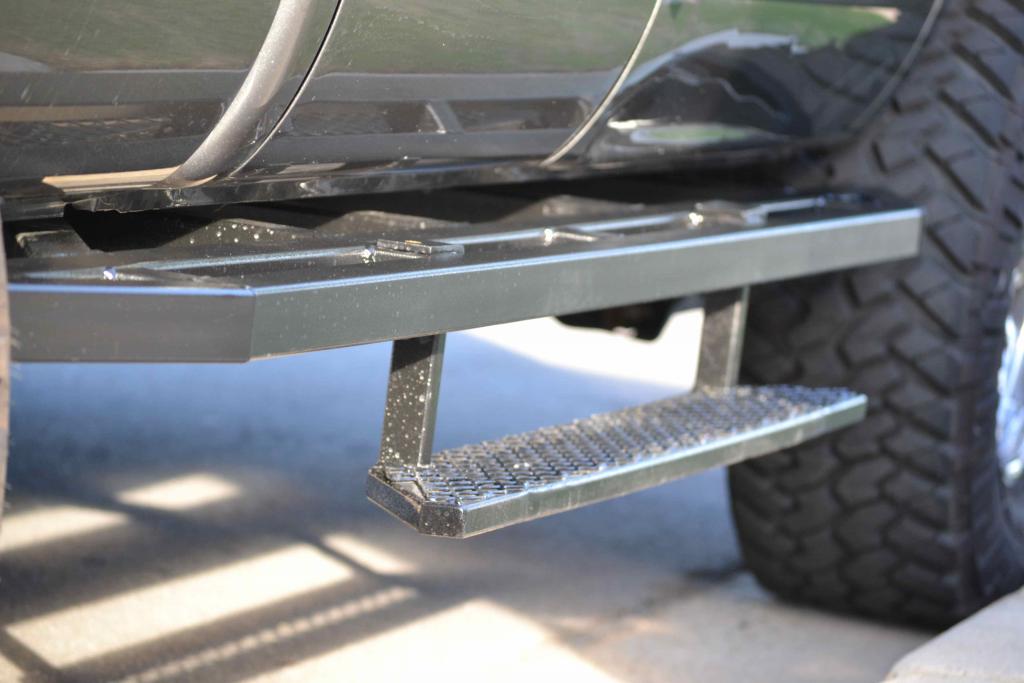

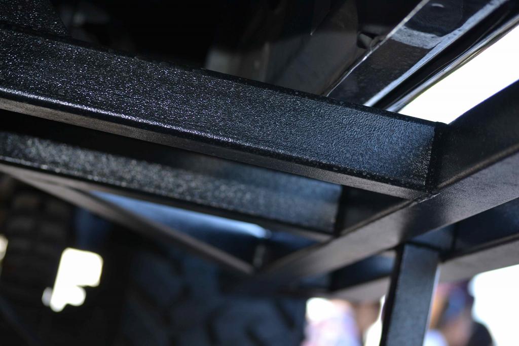

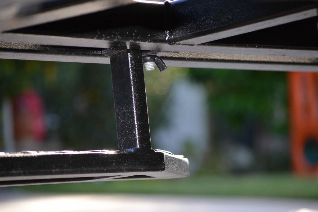

It has four attachment points that clamp around the frame. Two 1/2 inch sleeved bolts on top sandwich the frame. The steps remove with two wing nuts on each side.
Attached Thumbnails Been searching 3 years for Rock Rails/Steps-dsc_0584.jpg   Been searching 3 years for Rock Rails/Steps-dsc_0585.jpg   Been searching 3 years for Rock Rails/Steps-dsc_0586.jpg   Been searching 3 years for Rock Rails/Steps-dsc_0587.jpg   Been searching 3 years for Rock Rails/Steps-dsc_0588.jpg

Different views:
