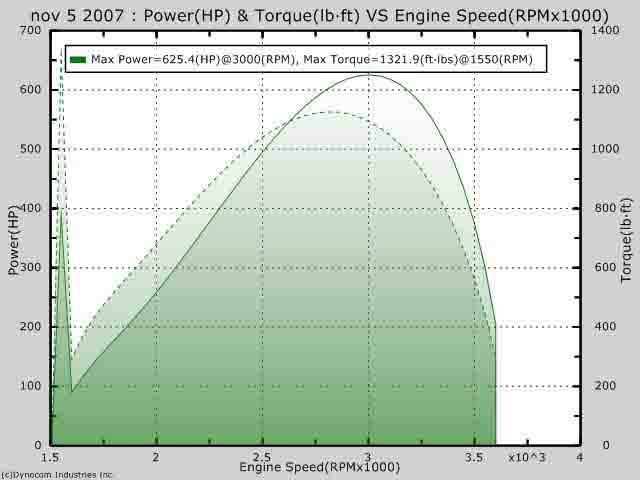

Here are a few dyno runs with the tow twins, the old Smarty Beta 4.4, and Flux 2.5's.
The Flux 2.5's are a bit much for the little twins, but it gives you a look at what is possible!
Properly tuned, the newer TNT(R) software would add another 30-50hp (more heat too).
Level 5
Level 9
We later determined that level 7 made the most power, but never dynod it again.

Jamie, those numbers with the BD towing twins are one of a kind.
I had the same set up with big sticks and the best I ran was a 575 on a 248 dynojet.
Making over 700 with the towing twins is not all that realistic.
I have yet to see a truck that makes numbers on a dynocom repeat the same on a dynojet or Mustang.
I will say they perform very well for what they are designed for.
But hey my experience is only one of many!

You must have the magic motor setup. DUKCALN couldn't get your Towing Twin numbers with his R-700 upgrade. Just about everything I've read and heard says 600hp is pushing the limit of the tow twins. Even with twin pumps, 90hp sticks, MP-8 maxed, and TNT-R on 7, my hp limit is right there at 600. What's the secret? Do you think putting Flux 2.5+ injectors in place of my 90hp injectors would add that 100hp you were able to achieve?

600 is what they are rated for and that will be about all you will get. If you want more hp than 600 you need to look at their bigger set or another company

I've heard that comment before, but I do have a bit of supporting info for you.
I was seeing over 70psi of boost.
Aaron dynod his Bullydog truck on Malcolm's Dynocom this summer.
He was 15Hp low of his dynojet numbers.....Pretty accurate if you ask me.
Malcolm ran back to back 13 flat with the identical setup to mine. Malcolm says his Mega cab with tool box and whatever weighs 8200 pounds.
Plug in the numbers, but as you can plainly see there is no way a 575hp truck can run a 13.00
http://www.race-cars.net/calculators/et_calculator.html
Before I had dual CP3's I dynod beside a guy running DDP 90's (with dual CP3's) with an otherwise identical setup to mine. I made another 85hp more same dyno same day and I did it with 17Kpsi rail pressure....I made 722 after I installed another CP3.
I dug the other guys run out of my emails for comparison
Just curious, but what was your exact tow twin setup Rob?

Jamie I was in Edmonton and witnessed Aarons runs. I call BS on towing twins making over 700hp. This argument comes from me on the dyno over 30 times trying to achieve 600. But hey maybe it was my bad luck.
Flux 3.5's, Stage 2 Floor it pump, Smarty beta 4.2,

Not trying to pick a fight, but here is no way a stage 2 could support Flux 3.5's.....A stage 2 can't support 2.5's for that matter.
I believe the Smarty 4.2 would hit the 3.5's too hard over-fueling the setup as soon as you dropped the hammer. This would cause poor initial roller acceleration then just as it got going the pump would fall off and the 4.2 would run out of rpms.....Killing what little was left of the run....
You can see from my (concave) dyno curves that even the Smarty 4.4 and Flux 2.5's were over-fueling the little turbos.
Was that your first setup or something?
All in fun!
