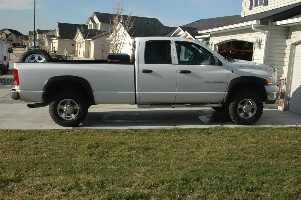

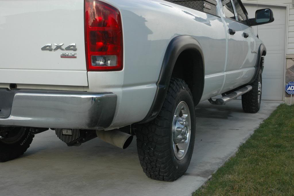

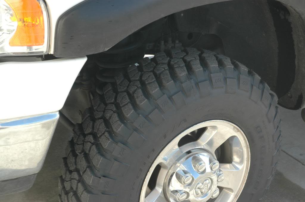

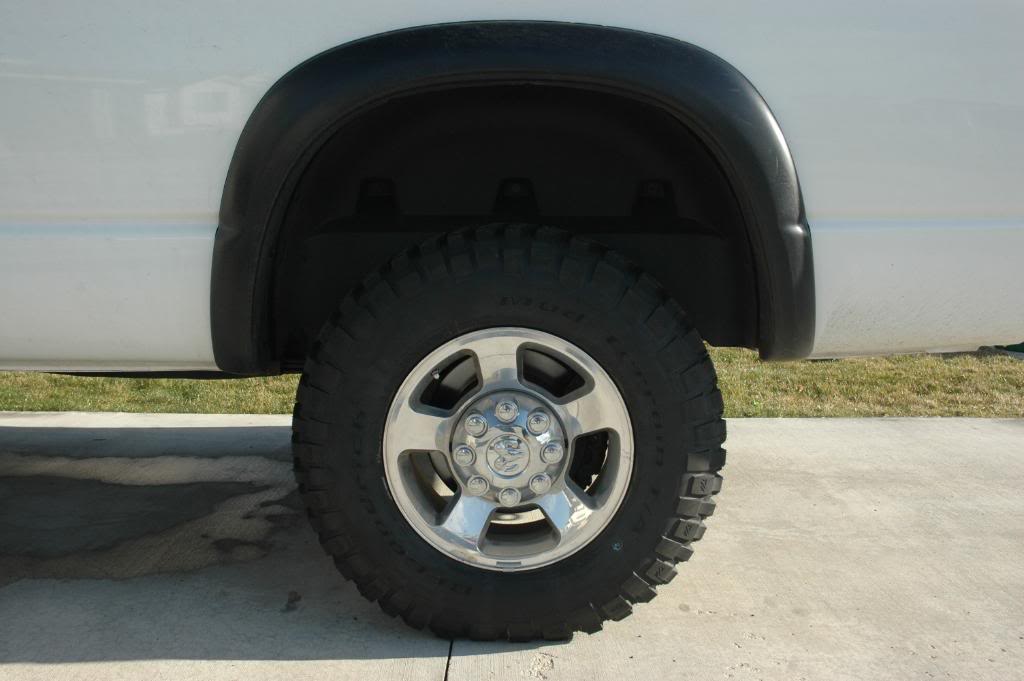

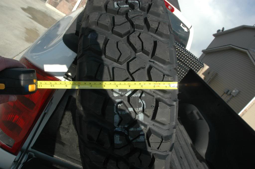

Initial impression is great. Noise is quieter than expected, and nothing annoying or even moderately loud, seems quieter than my brothers 285 KM2's. Ride is great, they have 60/40 in them now and seem smoother than my previous 285's (thou the weight capacity is lower too). They balanced out great, not too much different than the 285's, thou the tire itself is lighter. I can feel the difference in circumference, and its feels fine, thou haven't towed with them. I had to go about .8" taller on my Smarty Jr to get the speedo accurate.

that is one sweet lookin rig!!! i love the tall skinny tire look!

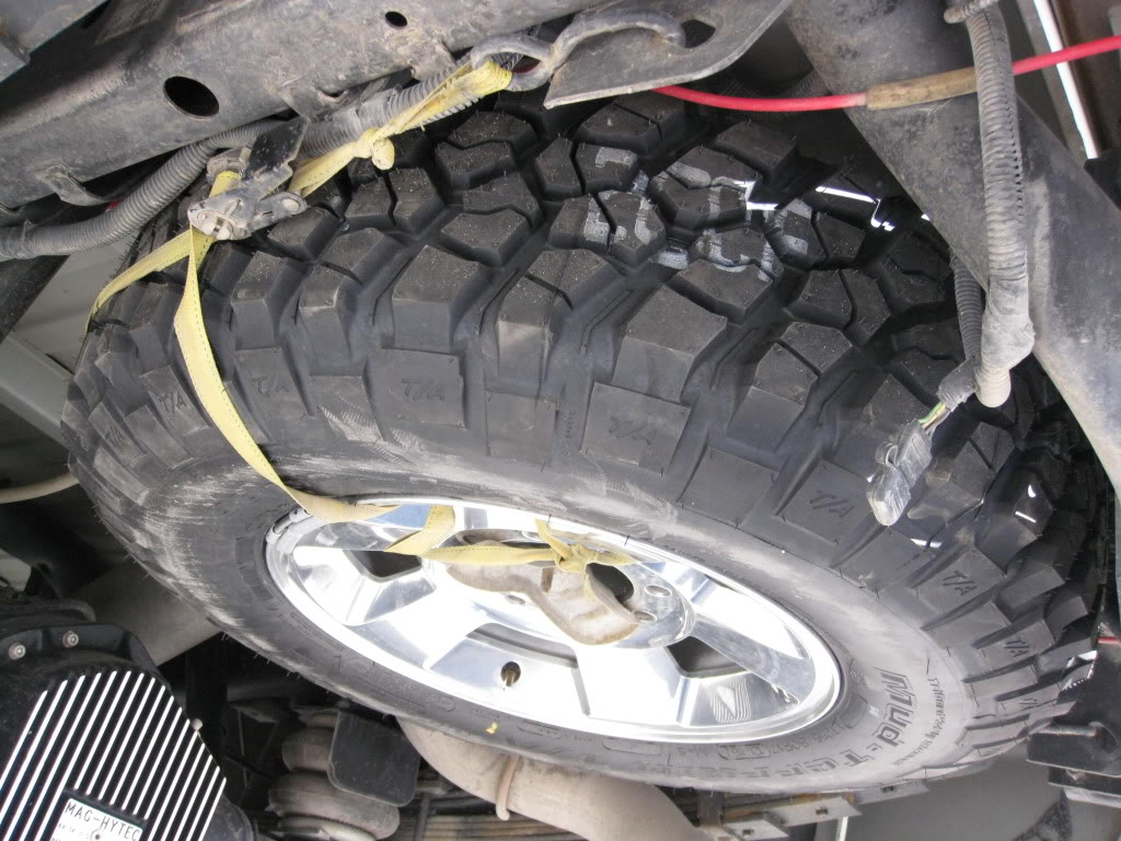

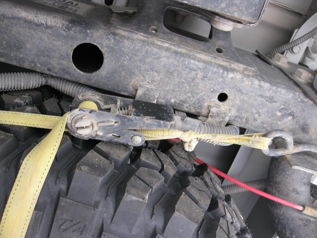

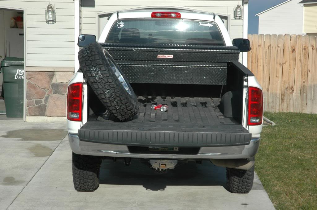

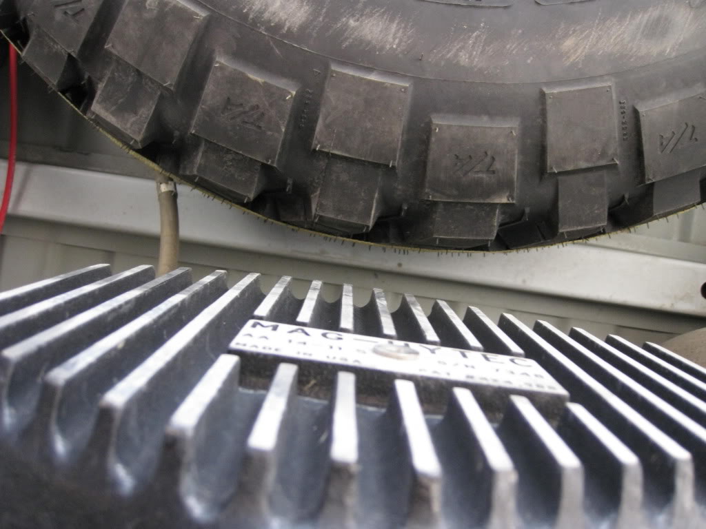

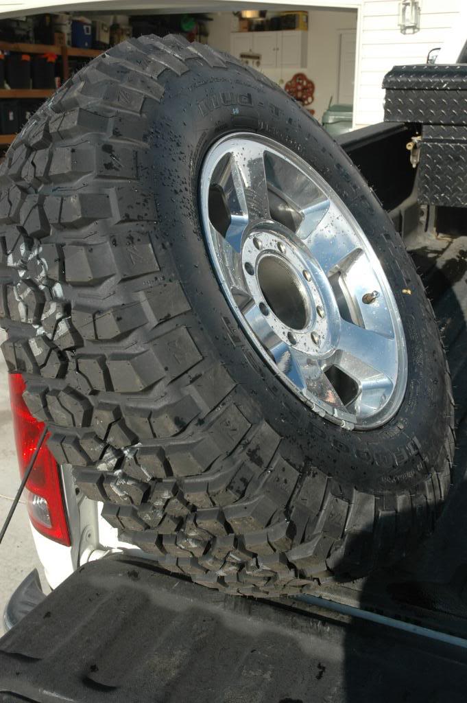

Spare fits.. Just like the 285 I had to use a ratchet strap to pull the tire aft so it would clear the mag-hytec diff cover, but plenty of clearance.
