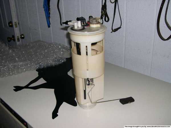

Here's a canister modded with the AD kit I think you were talking about?:
There's other kits available now but you still gotta remove the canister to install them.

This canister is for an 03-04 truck ( https://www.dieseltruckresource.com/...nister0001.jpg ) . Airdog will give you the adapters to couple directly to the factory location. That is coming for Charley at Airdog. Yes you lose flow rate drawing from a 3/8 pickup, as far as the return goes, I do not know the return rate of fuel to the tank, however I am sure it is less than the draw rate so 5/16 could be sufficient.
You can reach between the frame and disconnect the fuel lines on the earlier trucks.

Yes, I have the fitting connecting the ½" hose feeding the AD to the canister, it's called a Dorman fitting.
The 5/16 connection is the one from the engine,, both before and after the AD install, you still haven't explained how that gets the AD return into the canister?
Old May 5, 2009 | 10:29 PM
Hvytrkmech's Avatar
Posts: 2,013
My apology, I don't know why I misunderstood you . You are correct in the fact that the A/D needs its own return separate from the engine return.
