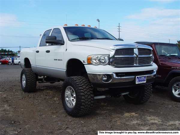

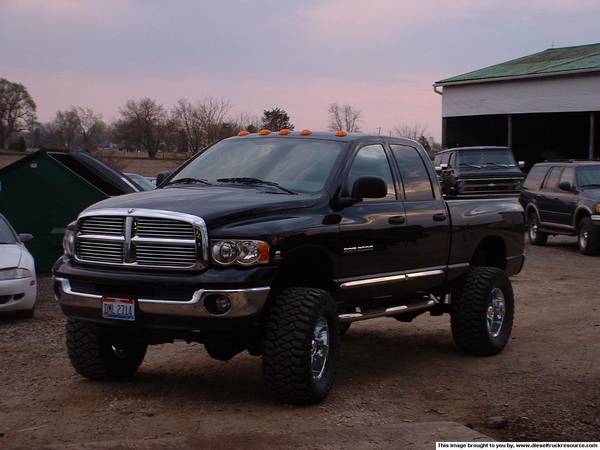

Anyone else had experience with this i am very interested in doing this to my truck as well. I am wanting to run a superlift or revtek 6 inch lift with a set of mickey thompson mtz 36x15.5-18 on a 18x10 rim with -25mm offset and 4.5 inch backspacing and am afraid that setup will rub. any input would be greatly appreciated.

Rub...rub bad! The offset, tire width, and rim width are wayyyyyy of. With any suspension compression...they will hit.

well look at Its All Good and Red Rocks truck they are both running 6inch lifts and are running the same tire on 18x12 i believe and they fit?
hopefully these guys dont mind me posting their pictures up!
