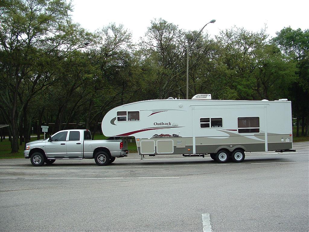

Old May 24, 2007 | 11:19 PM
PCM's Avatar
PCM
Posts: 313
From: St Augustine, FL
Caseyclan
Hope you are happy with your hitch choice and your Outback. I have one as well. So far, VERY pleased.
