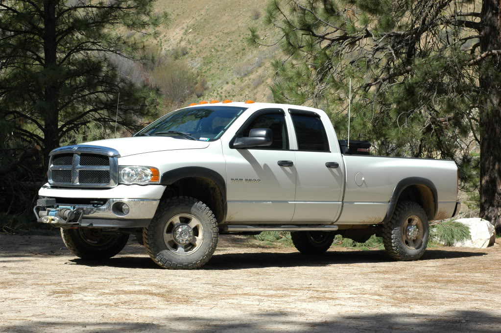

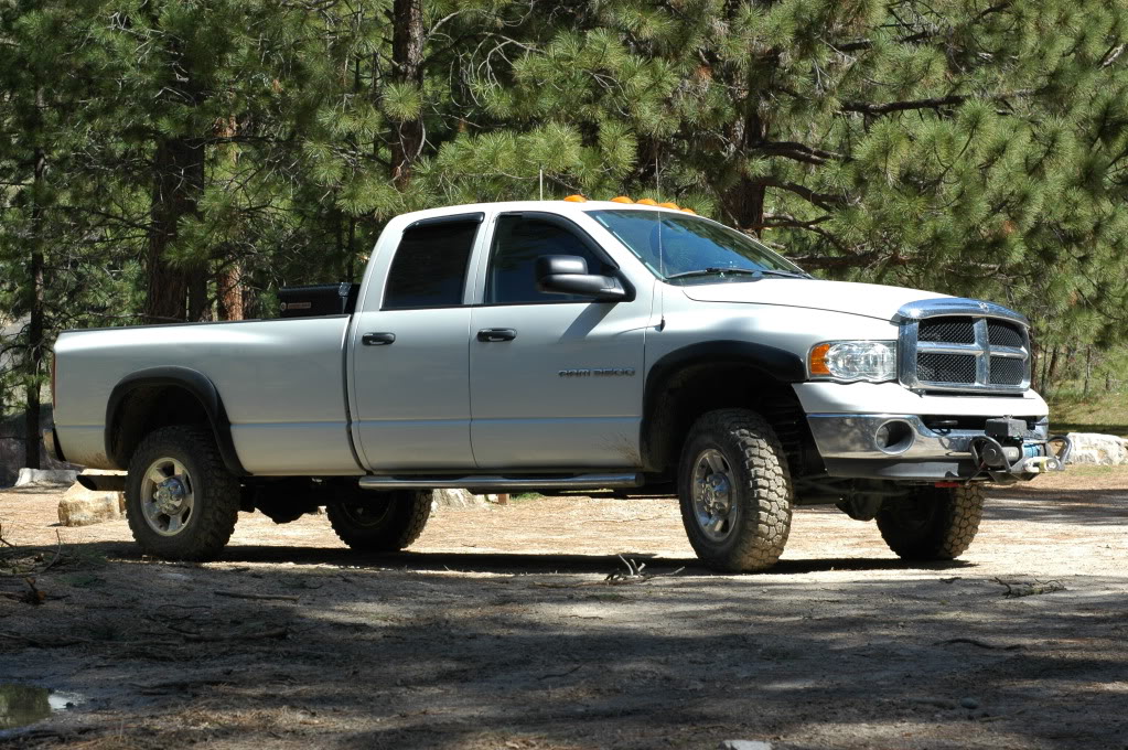

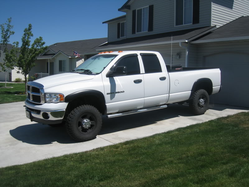

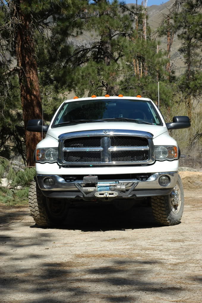

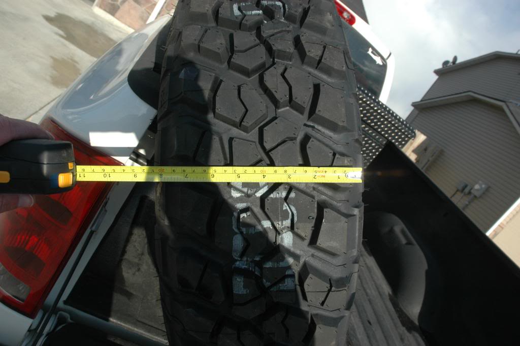

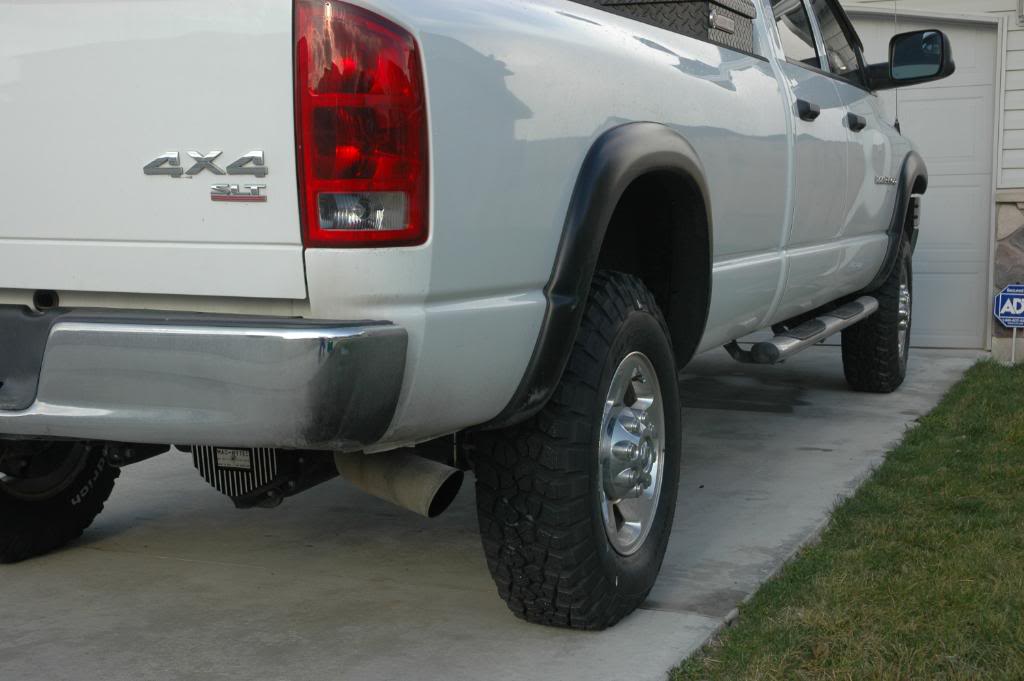

Originally Posted by skindaddy
AH64ID how's the 255/80 look on the truck?, not familar with that size
Essentially a 33x10.50. Narrow tread at 7.5".

Originally Posted by Raspy
There's a lot more to mileage than tire diameter.
Yep, I am running a taller, lighter, narrower tire at more pressure and the mpgs haven't appeared to change much.. mainly because I went with a MT.. even thou the rest of the equation means easier rolling, the tread pattern makes the biggest difference.
