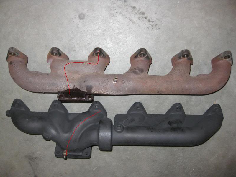

I reccommend the Pac Brake PXRB for your 2004.5, with a Garrett Stage 2 and a ATS 3rd gen exhaust manifold.
The ATS (even the stock 3rd gen) is 3/3, but the ATS fixes the poor flow of the OEM one.
Be advised that the BB turbo's will push a little more oil on a variable oriface exhaust brake like the PXRB. Anytime the backpressure exceeds oil pressure this can happen. Not a big deal, but don't be shocked if you see oil in the intake tube headed towards the intercooler. The non-variable (Jake/Banks) will do it a little but, but no where near as much.
