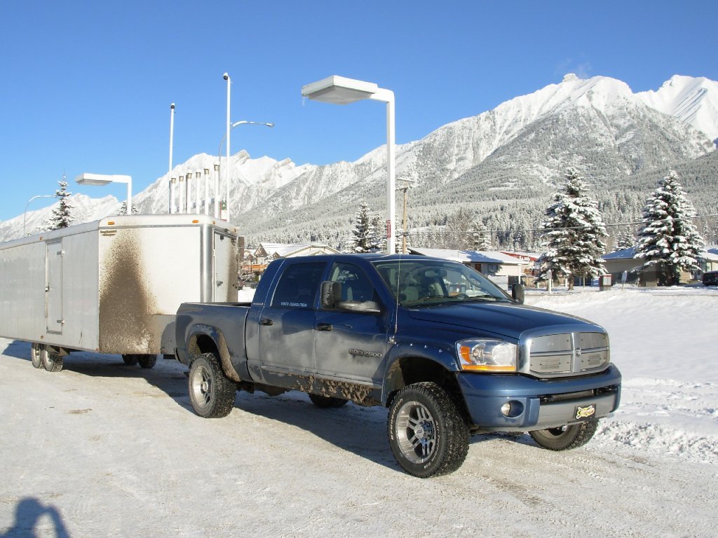

Here's a pic of of some nice dirty 20" Motometals, I had 35" Mickey Thompson's on it but it rubbed a little too hard for me. I didn't want to lift it any higher or it wouldn't fit in my garage. Getting chilly up there again?

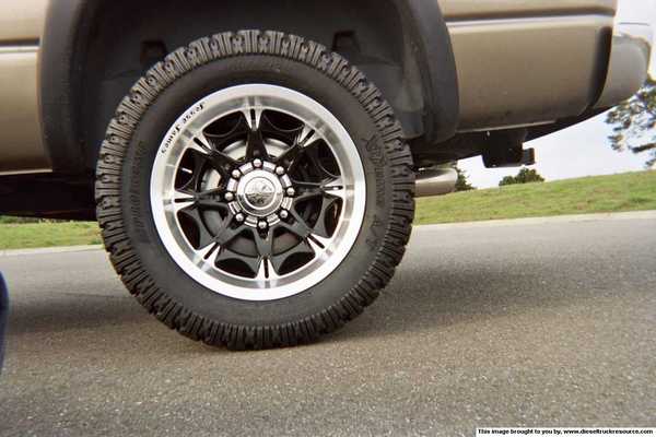

Here's a pic of the 18" Eagle 114's with 35" Toyos. Dont worry you dont need a lift and Ive seen other pics of this guy's truck with the same rims and tires w/o a lift
