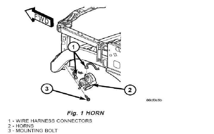

How's this?

You're awsome! To me, it shows it's mounted on the lower side of the framerail.............or am I out to lunch? At work right now on my CrackBerry, so no truck to look for it for real................or a bigger screen until home tonight.

You have to remove the driver's inner fender liner and it is mounted up above it right in the middle. On earlier trucks it was mounted further forward.
This could be interesting. I have mudflaps and fender trim.

It is done............and tested. Whoohoo - a custom mounted set of Grover 24.5" Stuttertones (designed for fire trucks)!!
Thanks for all the help in locating the truck horn folks.
What a pain to tap into the horn wires though.
