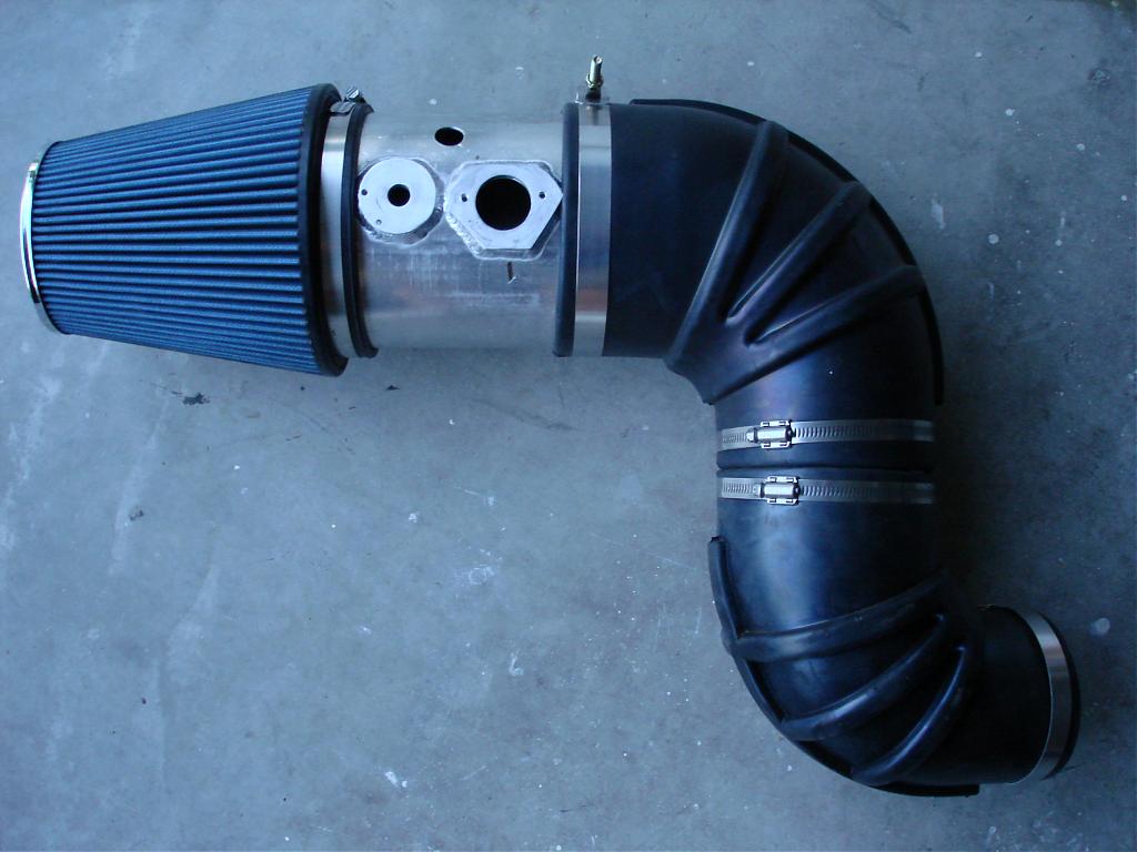

Here is my version of the 6.7 *****'s whistler. ( Stage I ) This alone makes plenty of music in my opinion.
Silencer ring on 6.7-dsc00458.jpg[/SIZE]
