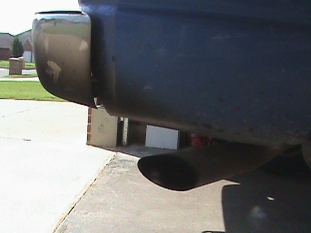

I have never towed a thing with this truck. Just when you throttle it hard is when you can see smoke. Here is a pic of pipe rear quarter and bumper. I showed it to the service writer he said the new flash would take care of it ( ha ha ). I think I have a cracked converter and if I go in and sit on them they might check it out, the problem is I don't have the time to do it.

looks good having the black stuff on the back didnt think the 6.7 was going to do that

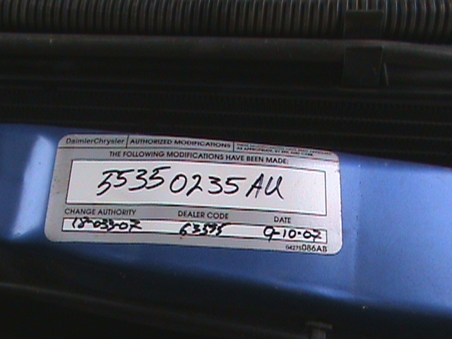

Whats the whole number for the flash? I have revision B from June but want to get the latest flash available as I have no warranty!

Here you go. Click to enlarge.

Was at the dealer this morning for an oil change and ask them to look for the AU number and they could find nothing. How about some more clues so I can get them in the right ball Park? They did check for codes and found nothing. So that much I am happy about.

The flash is part of TSB 18-033-07. The TSB has not been updated, but there is a new version of software associated with the TSB. Version AT -> AU. It the tech attempts to apply the PCM flash using the instructions from this TSB, the newest software version will be downloaded.

WOW, Nice to see some soot on a 6.7L!!! It is a diesel!!!!!!!!!!!!
