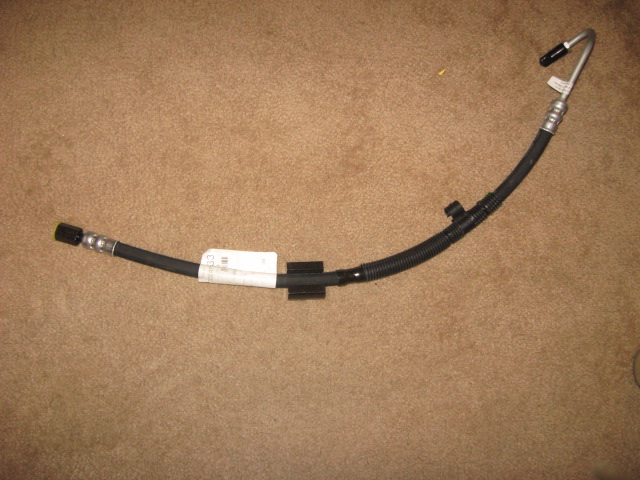

can someone post a picture of the updated high pressure steering line that dodge is putting on all the vehicals with the
"2000 rpm" vibration issue.
I think im having the issue but i cant tell if my hose is the updated or the origional.

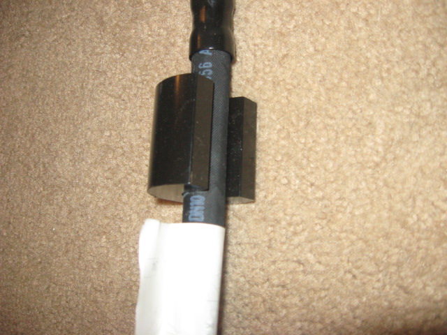

This is the hose with the added weight. This is an unused OEM hose I purchased for my 2004 before I found that it already had the new hose. I'll sell it at a discount - $25 shipped. PM me.

so is that all they changed in the design? Just the added weight? I heard they also added some kind of baffle inside the hose too, to keep the fluid from pulsating.

Appears to be a regular high pressure hose with the added weight.

They just didn't add weights it was a updated hose.Otherwise they just would have added a weight.

I had mine done under warranty. The hose (on mine anyway) has a weight in the middle, but it also has a metal fitting mid-span that seems to kind of narrow in the middle.
