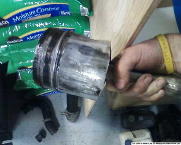

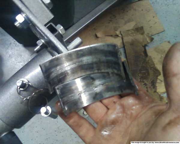

From: Eagle River, AK
Exclamation
What ever you do MAKE SURE that the old filter gasket is not still on the filter base.... My bro screwed up ....
Rod bearing on #6
#6 piston
So far he is in it for about $1500.... drove 8 miles till it started to knock.... still had oil pressure.
not a good day for him.
MM
