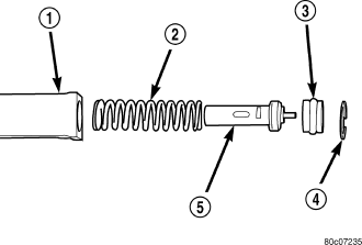

Originally Posted by no_6_oh_no
When you find that elusive little bugger you post a pic.
The parts of the t/stat.
#2 is the t/stat.
Attached Thumbnails Transmission Temp-trans-cooler-t_stat.gif   Transmission Temp-trans-cooler.gif
Old Jan 17, 2010 | 05:47 PM
no_6_oh_no's Avatar
Posts: 2,756
From: McDonough GA
#2 is the t/stat.
Thank you, that is what I was looking for.

is that picture the checkball?
Old Jun 30, 2010 | 07:13 PM
07 ThunderRoad's Avatar
Joined: Dec 2009
Posts: 189
From: Ohio
NO! The first pic is the exploded view of the t/stat. the second pic is the location of the t/stat in the air to oil cooler.
