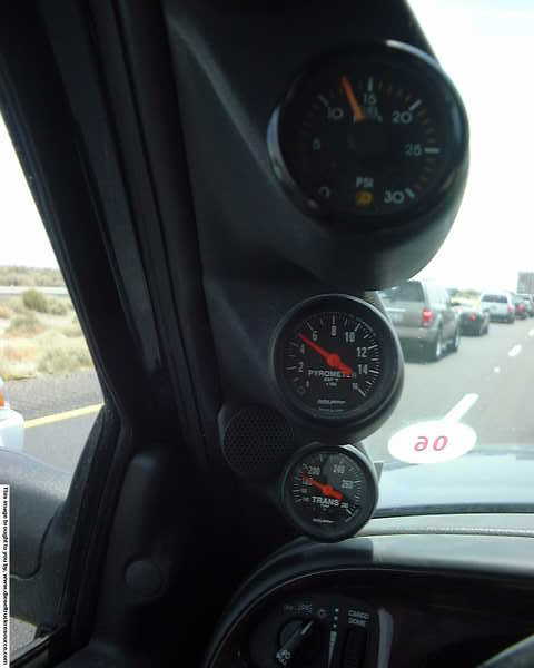

dssimecek's Avatar
Posts: 520
From: Cypress. Texas 77433
That tempature don't sound right. Here is a pix of mine. Hot day in Arizona, been on the road, and now is stop and go traffice on I-10 out of Phoenix. Not sure, but think mine is mounted on the line to the cooler.
A hand held IR thermometer like from Radio Shack is a handy tool to have. Pull the tranny dipstick and read the tempature of it with the trans fluid on it. See what it reads. Good luck.
