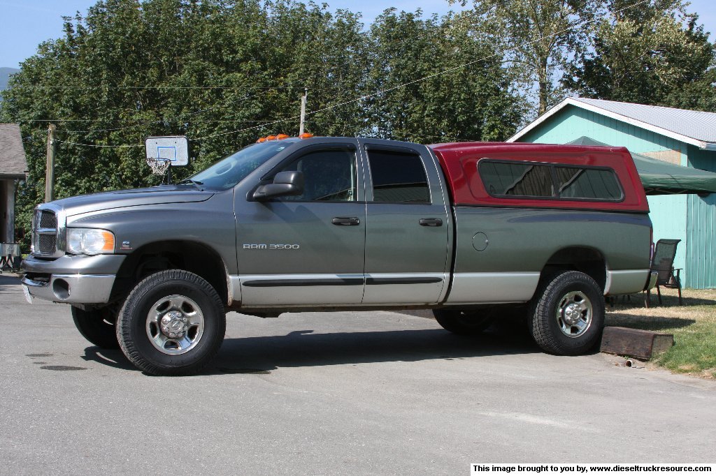

Finally got around to buying the new set of toyos. 285/75R17 ATs
They measure 31.75" on the truck. So both sets bfg and toyos lost about 2" from their rating once under load.
I think its a good choice. I wanted the height but not as much width and thats what I got.
Old Jul 21, 2010 | 08:39 AM
Crazy_Farmer's Avatar
Joined: May 2009
Posts: 54
From: B.C
Everyone likes pictures so heres the truck with the 285/75R17s
I really need to get that canopy painted lol
