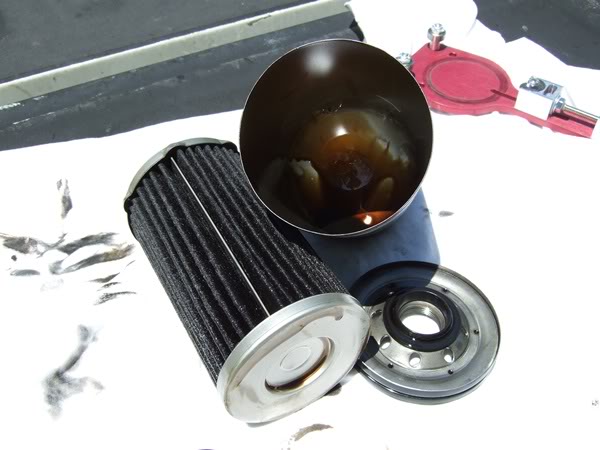

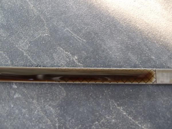

I have been doing the 1yr/25k intervals for 100,000 mile now. This oil had 27,600 miles on it using Amsoil AME 15W-40 and one Amsoil EaO80 filter. I do not use a bypass filter. I got my oil analysis results back and the oil was good for continued use. This pic was taken just before I drained the oil and took the sample. Second pic is the oil filter that was removed during this oil change.
All wear metals were well within limits as were contaminants.
Soot < .1%
Fuel dilution < 1%
TBN 5.50

Thanks,, who does your Oil analysis for you???
wow, that is the cleanest oil I have ever seen on a third Gen cummins,,, is that a tool that opens the filter???? is your engine basically stock like Mine???

I use Oil Analyzers Inc. for the analysis.
The filter cutter I got from Amazon. $60 shipped. It's the longacre brand.
My truck is an 04. it is known for clean oil. Only thing my truck has is the Smarty Jr that I run on the 70hp tune all the time. Towing I put it back to the 40hp tune.
