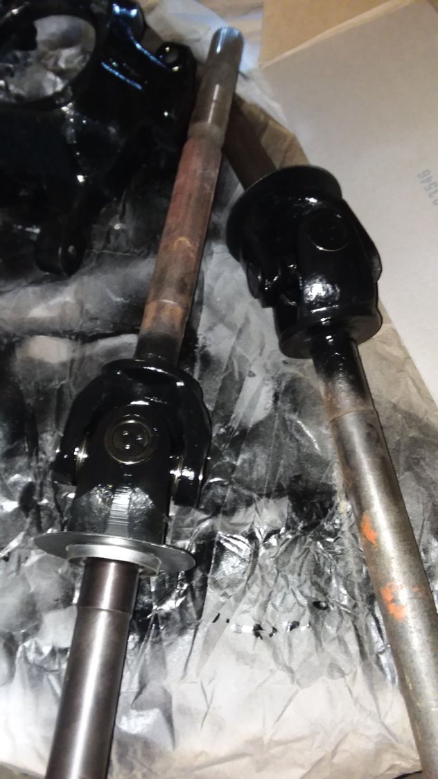

New rotors with brake pads pretty
Toyo 35 in tires the hub's only stick out the width of the mile marker lockouts
Just need a four and a quarter inch hole saw for the hubcaps and I should be finished
Homemade bearing puller with a 3/4 inch Bolt work great after the Hub was broken loose with the power steering
Universals in
Took 4 hours to D rust Knuckles but they look good after they're painted
Painted and ball joints in
Just finished the spyntec free Spin kit on the front of my Dodge diesel 06 went fairly well will update later here's the pictures
