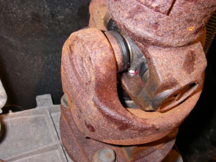

1) Finding the fitting will be your first challenge, it is really tucked way back up in there, and it is not at all obvious. The Chrysler documentation, ~identical in both the owner's and service manuals, sets the standard for worthlessness (see attached...) - although it does provide reinforcement for the belief, before the personal discovery of any evidence to the contrary, that this thing both exists and does need to be lubed. Note to mods - this page from the owners manual is freely available on the chrysler website, and should also easily qualify under the "fair use" standard, hence no copyright infringment applies.

After repeatedly driving the truck back and forth a few inches at a time (eventually getting pretty good at estimating what distance traveled converted to what angle of drive shaft rotation!), and peering over and over again at the cardan joint from different angles, and repeatedly comparing it to the pictures I'd printed out from here (an absolutely necessary, if not necessarily sufficient, step in the process), and trying to hold those printouts at the same angle as the driveshaft, and craning my neck back and forth while trying to see around corners, and scraping dirt/rust/whatever off of various possible locations... eventually I saw this tiny little dimple thing, set back around a corner in a hollow, that I eventually convinced myself really was the elusive grease fitting!
Trust me, it is not easy to see from a lot of angles, and impossible from many, but it is there! Pix are attached, showing the best shot I could get of the actual fitting (it's that shiny little spot in the inside of the forward-most yoke of the cardan joint, and of the fitting in relation to that end of the prop shaft coming out of the xfr case.

This is what we called a pin zert fitting. I have seen them before on the double cardan type u-joints. Been around for years.

There appears to be two different types of grease fittings on these joints.
Some use the pin zert that you mention that requires a ball to be pushed in. Mine is a rubber plug that takes a syringe type needle has to be used and pushed through the plug to get the grease inside.
Interesting, first time I've seen anybody post about the joint having a rubber plug. Mine has the "female" zerk fitting.
