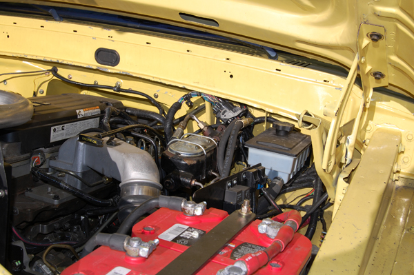

OK, I've attached an image of the relays they left me with. I've sent to AutoWorld as well, but I won't hear from them in a few days. If anyone recognized these let me know.
1 & 2 take power to a do-dabber where the intake meets the heat - intake heater?
3 I haven't figured out
The input to 5 looks like the original crank signal (and the relay might be the original starting relay), but it runs through relay 4. Which is confusing. The yellow wire you see leaving 5 runs down to the starter.
As soo as I get someone to operate the key while I use the voltmeter hopefully I'll figure out one of these is toast.
Peter

Here are a few photos.
I tracked it down to the neutral saftey switch. Bypassed that and its running for now.
Thanks for all the help.
Peter
