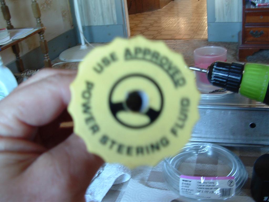

Well, I've had it with my power steering not venting through the most wonderfly designed cap (yes, that was sarcastic) and pushing fluid out the top of my PS box and all over the driveway! So I came up with a simple way to vent it! I have pics and parts so you can do it to!
Tools:
3/8 drill bit
9/32 drill bit

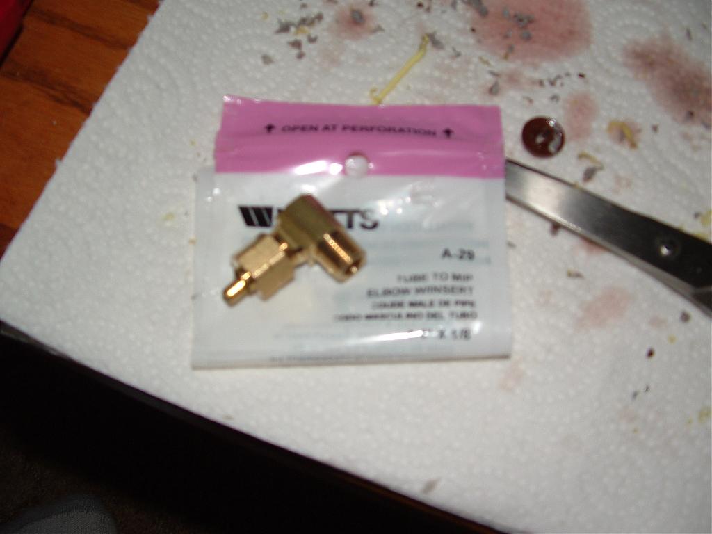

Parts: (got at Lowes)
Watts Brass tube to MIP elbow w/insert 1/4" x 1/8"...pt#A-29....$2.78
Watts clear vinyl tubing 1/4" x .170" x 20'...........pt#42143220..$1.96
Just take the 9/32 bit and drill through the top of cap about 1 1/4" down. You'll encounter a rubber piece just under the cap you will have to yank out after drilling. You'll also knotice just under the rubber O ring on the shaft the bit will have cleared a hole accross shaft (pic-1) Then take the 3/8 bit and drill 1/4" down. Make sure all shavings are cleard. Take the brass elbow and insert it into the cap and force-thread it. anthe connect the tubing and you're done. Install back on PS pump and run tube to desired location. NOTE: Don not face end of tube up! Make sure it faces down! Good luck!

I did it because I had a problem with fluid all of a sudden coming out of the top of the box where the steering shaft enters. Now every time I took the cap off to check the fluid it poped up in my hand with pressure behind it. Now I talked to a couple of members here and they concured that the cap wasn't venting properly and they had the same problem. Well if you look at the stock design you can understand how it can get cloged and pluged! My design hopefuly eliminate that! My seals are probably ruined now but, we'll see!
