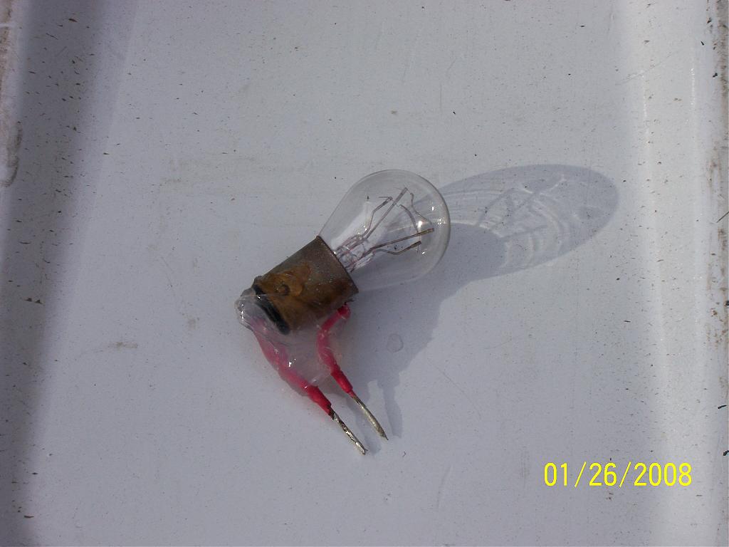

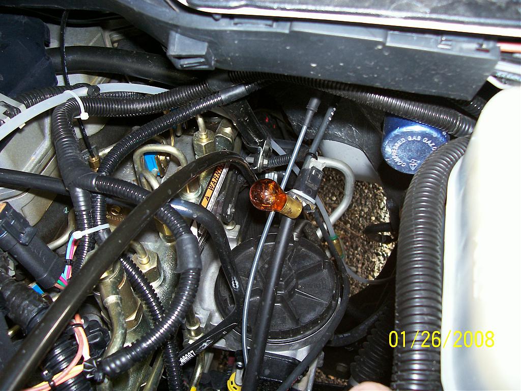

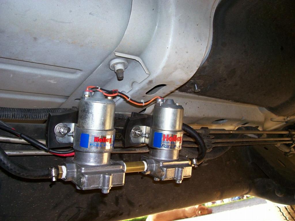

When I substituted my twin Holleys hangin on the frame rail for the stock pump attached to the filter cannister I got that code. The ECM is looking for a load attached to the wires that led to the original fuel pump. If it doesnt see that load then that code pops up. I ran a seperate wire for my pumps because that whimpy wire assembly to the stock pump didnt look like it would handle what I was asking it to do... so I had nothing attached to the original pump harness, hence the code. So... I fooled the ECM into thinking something was attached drawing power, like a fuel pump, and never got a code after that. What did I attach?
A yellow coated tail-light bulb. Yellow because the bright white was too distrating under the hood at night and yellow because I had one extra. If you do like I did and cut off the harness connector fromt he original lift pump (if you can find one) with a bandsaw and solder the bulb contacts to it, it'll plug right in and look and work great, if no connector then just solder a couple of wires to the bulb and push them into the mating connector of the harness wiring.
If none of the above applies to your situation, check the pump to make sure it's working up to snuff. If it starts failing, it'll be just like the original and set codes and cause your truck engine to drop in RPM at the higher loads, (higher speeds or when pulling)
I have several pics in threads I've posted on the board, you can go search and see what I've done.
