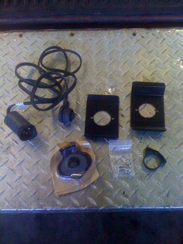

The Wigidigit from Geno's isn't the Marinco plug anymore. They went with a all in one piece design. The end that connects to the block heater doesn't even screw on. It uses a self locking plastic clamp now.
This is what I did five years ago using the Marinco 150BBI. Still works like a champ.

Yeah, I saw that when I did a quick run through yesterday on Genos site. I tried electrical and cold weather sections but never found the Marinco receptacle.
Bass Pro had a couple other plugs just like the Marinco that were a few bucks cheaper. But they didn't look as quality as the Marinco plastic.

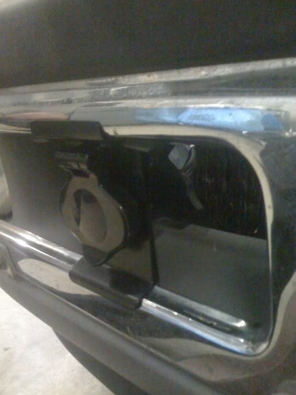

Finishing photos
Secured plug to bumper, got loom on wire and run on the frame rail. I used existing .25" holes to push pin the clips. I also had to drill out the holes in the clips to 5/8" to get the push pins to fit. Pressed pins into frame then lightly tapped with the rubber mallet to set.
A little extra cord, might cut to length but not a big deal. Zip-tied to the bumper with the fog light loom
Ready to go
