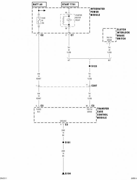

did you check fuse? I think it's fuse #43 should be 25 amp.
if fuse is blown may have electric shift motor going out or short in wiring. Check wires at the shift motor make sure there are no wires rubbing anywhere that could have shorted out.
Attached Thumbnails No power on the electronic shift controller on the dash-81584cf0.jpg

Checked the fuse and used a test light to make sure there is power at the fuse clips. Everything is good. Rechecked the wires and I cannot see anything but I will check the plugs for power and any resistance.
