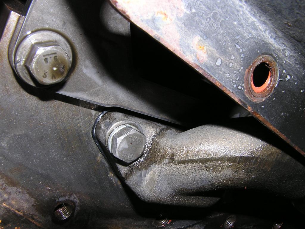

Ok, I got the pan off... Good news is I found the culprit, a cracked oil pickup tube. I must have missed it when I rebuilt the engine - or it cracked after the fact? Bad news is the bearings are toast. I only pulled #3 and #4 rods and wow, #4 is mushroomed bad. Crank looks ok on those two and mic says 2.717, clean and round. Had to clean #4 with emory cloth, it had a lot of babbit stuck to it - maybe that is what saved the journal? I'm not counting my chicks until I inspect all the journals though. Has anyone ever reassembled an engine with a marginal condition crank? With scratches, worn down or out-of-round tolerances? Any regrets from not pulling the crank to machine it? So far I'm lucky, but who knows what I'm going to see when I get to the rest of the journals...
