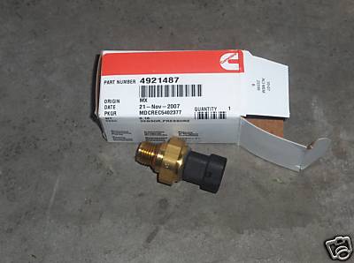

what the heck is this thing made of... I would love to know what makes it this expensive.

do u have to have a special socket to get at it? like an O2 sensor socket??
Nope just a 1 1/16" deep socket.
