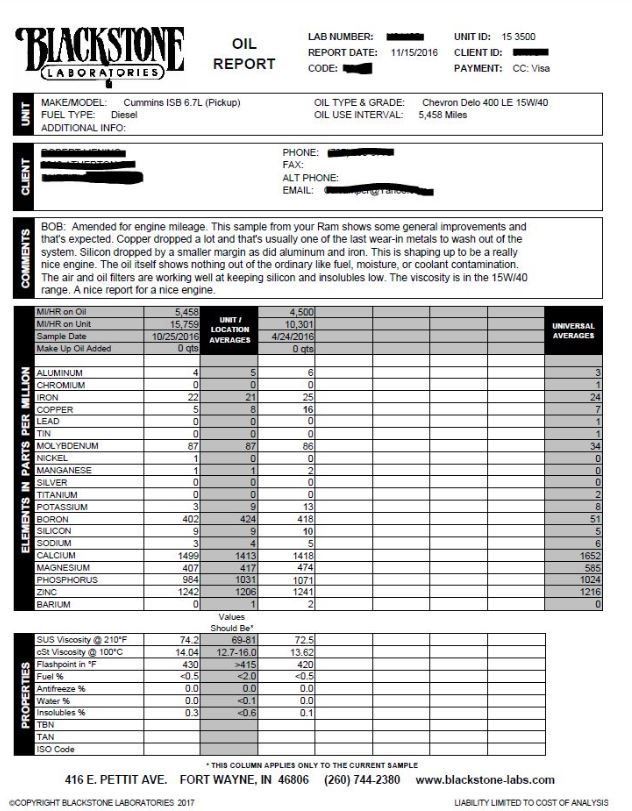

OK, there are two tests you can do for diesel in the oil. The first one is a paper test. Some folks swear by it, some say it is bogus. Essentially, you put a drop of oil from the dip stick on a paper towel and watch as it expands. If a lighter ring goes out further than the darker oil, that shows diesel in the oil. Some say the test won't give accurate results on fresh oil, some say it works better on computer white paper.
The second test is extremely accurate but costs more than a piece of paper. Blackstone Labs will send you sample containers for free, with pre-paid postage already attached. Fill a sample container, fill out the included form, pay I think $25-30 (don't remember), send it in. I usually get my results in a few days. I'm happy with them and use them every oil change to keep on top of what the engine is doing. Is it necessary to do it every change? No, but I do it anyway.
Here is a copy of one of my lab results. Fuel in oil is near the bottom.
