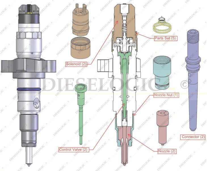

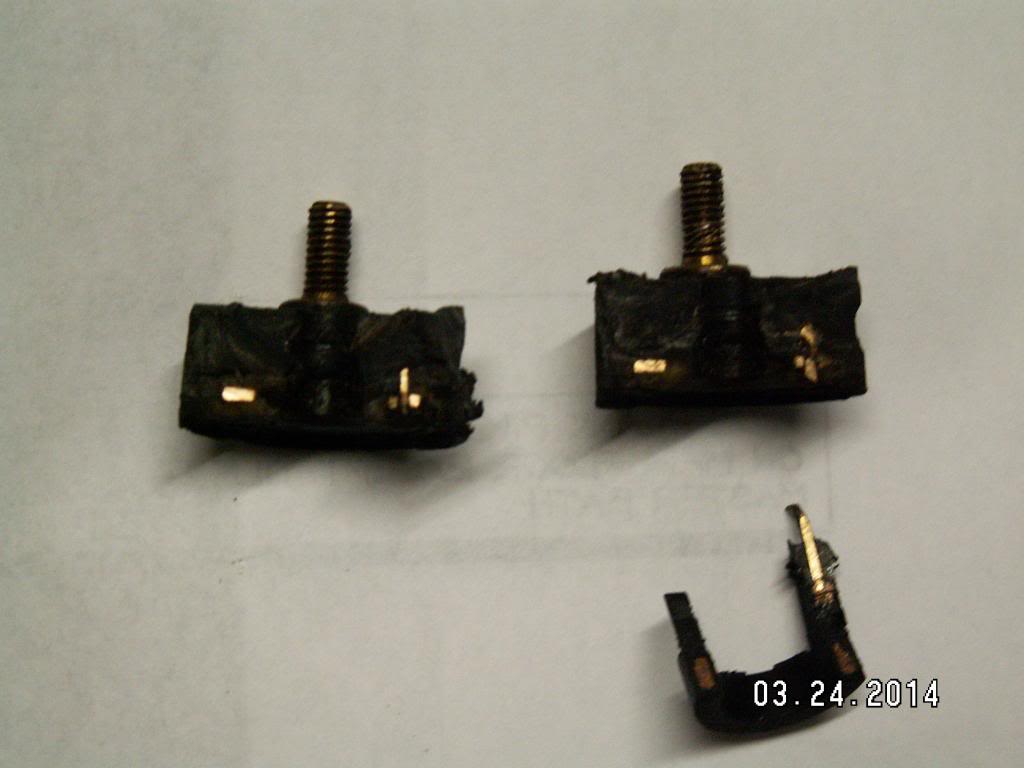

i cut one open to see why it failed, the way it is built it will make no difference if the wires are reversed. incidentally the reason for a solenoid failure is a design flaw on how the coil is attached to the post, i was lucky enough to cut it into at the point of failure to see it. you can replace the solenoid in about 5 minutes without removing the injector
