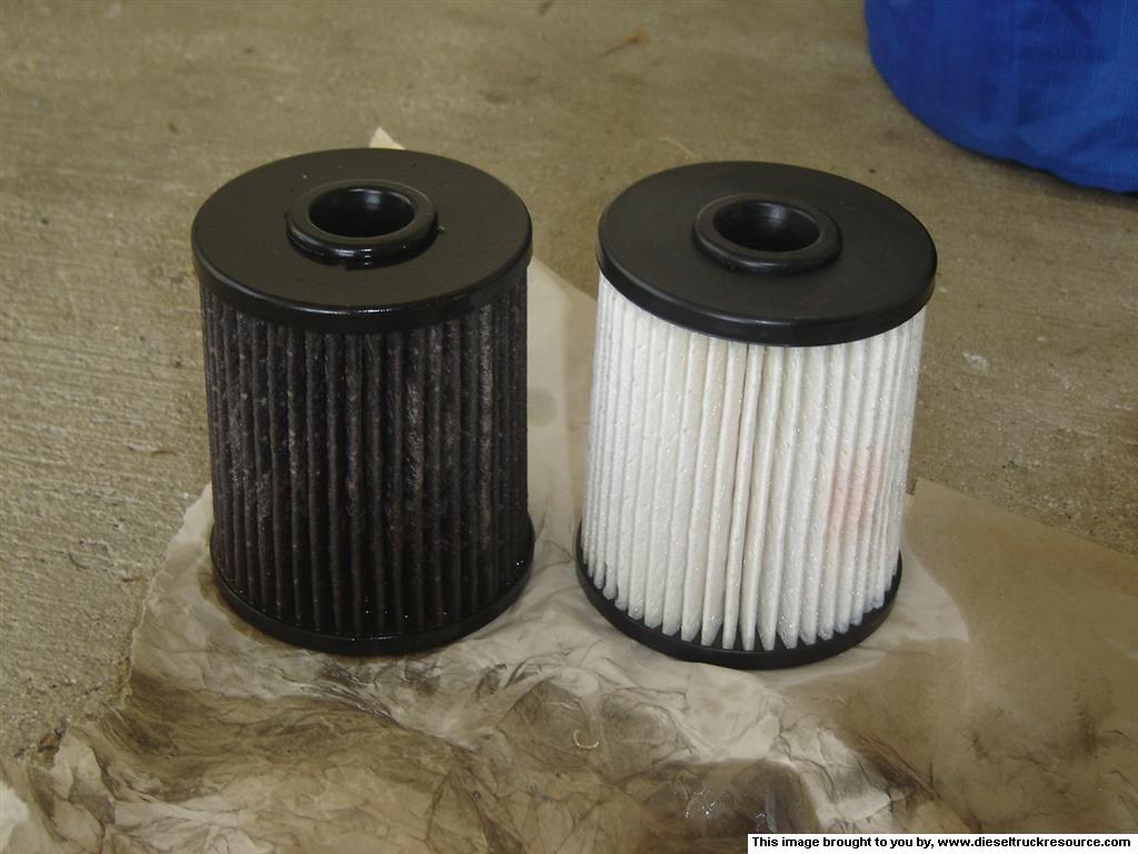

Which is a great reason to change your fuel filters periodically.
Here is another reason, the dirty filter here had ~10,000 miles on it, and is a Fleetguard Stratapore.

I run a PS/MMO mix but I have never realized any gain from it like some members claim. No better mileage, no better idle, no smoother performance.
My filters always look like that too. It's normal but I also change mine with every 2nd oil change. This time it just needed it 1000 miles early.
