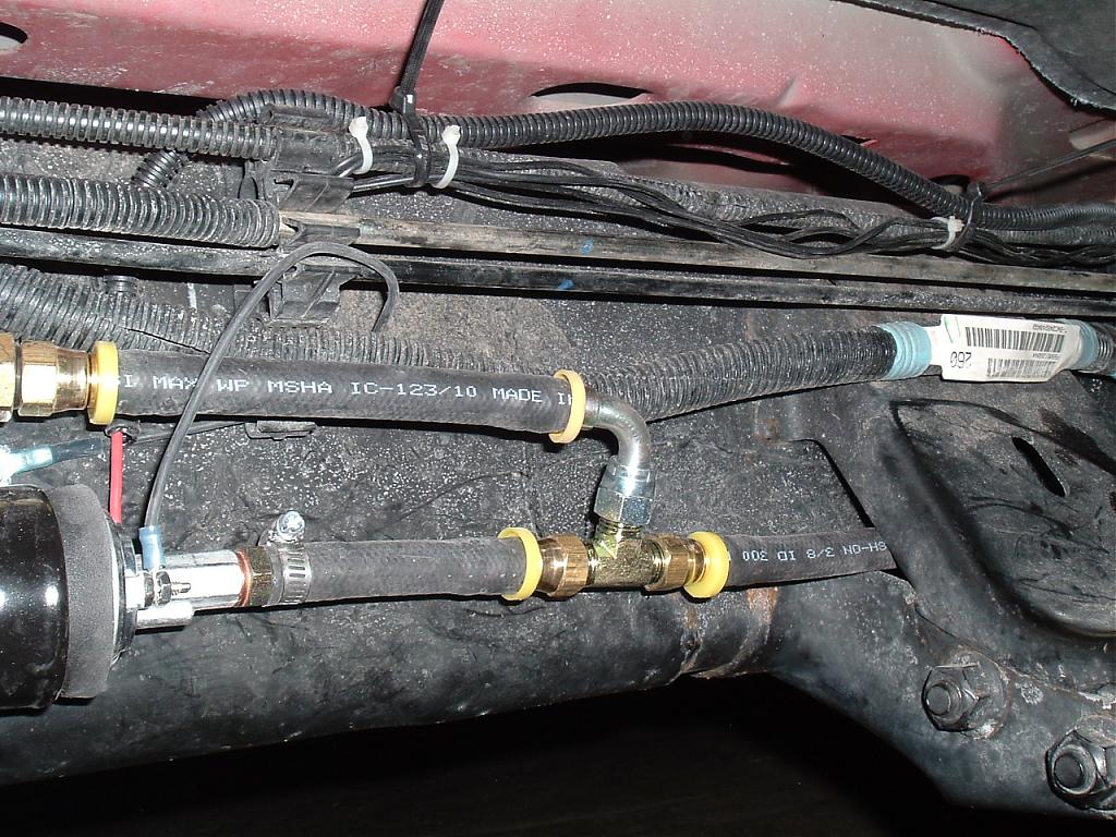

tritont's Avatar
Posts: 1,806
From: NC
this is right inside the drivers side frame in front of the fuel tank. You can see the transfer case right in front of the filter....

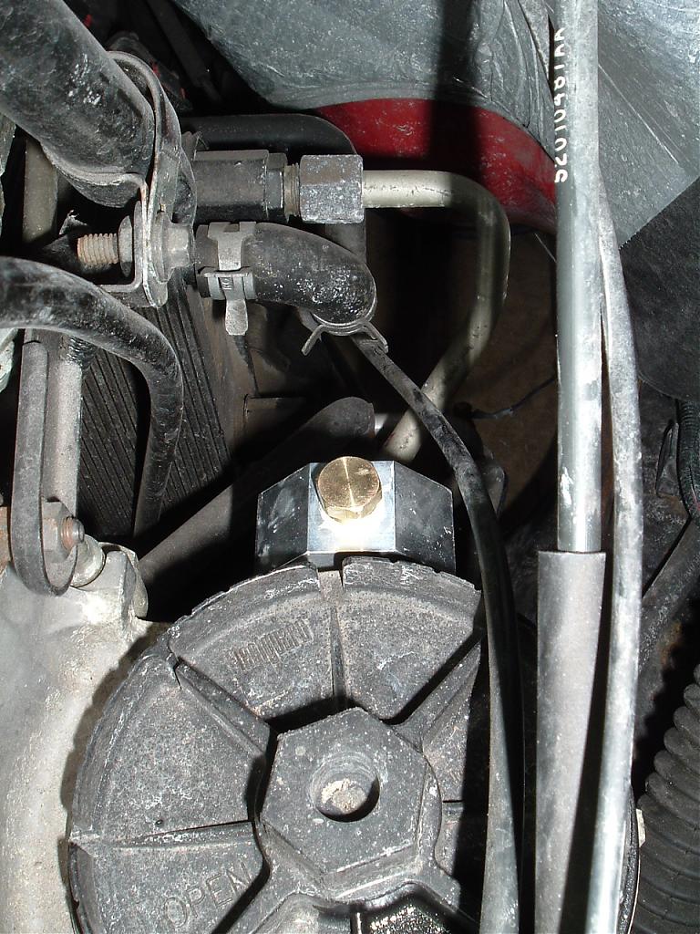

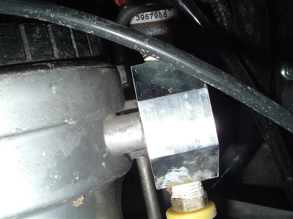

Old Apr 12, 2007 | 06:15 AM
samfox737's Avatar
Joined: Oct 2002
Posts: 61
From: Aldie, VA
Well I installed my pump, very easy install!! Still have some clean up to do (trim tiestraps). Next is a fuel preeeure gauge

Old Apr 12, 2007 | 09:04 AM
53 willys's Avatar
Posts: 6,259
From: Utah
hey tritont, do you have a parts list of all those fitting and hoes you used to install your pump kit??
that is one CLEAN install
I know me and I bet others would love to copy your install...we just need a parts list
Nice work
Thanks for your help
Mark
Old Apr 12, 2007 | 09:16 AM
Fisherguy's Avatar
Joined: Feb 2004
Posts: 3,640
So I'm looking at those pics, looks like you're cutting into the main fuel line, then there's 2 lines going to the motor? How's that work?
The steel braided looks sharp, but there's still a hose clamp or tie wrap coming off that top line, where's that one go?
Also, if the stock pump is only good for 8 lbs at an idle, do you leave it in or need to take it out to getr more flow?
My BD on extreme gets my fuel pressure down to ZERO when I really get into it,
might be doing a pump down the road, gotta figure what's involved.
Old Apr 12, 2007 | 12:02 PM
MikeyB's Avatar
Joined: Oct 2002
Posts: 7,543
From: Tomball, Texas
There is one main fuel line, the other line is the return from the CP3 to the tank.

Old Apr 12, 2007 | 06:06 PM
Fisherguy's Avatar
Joined: Feb 2004
Posts: 3,640
Was at the Glacier site, downloade the installation instructions, I see now how it works, gotta run a new line into the tank.

Old Apr 12, 2007 | 06:33 PM
tritont's Avatar
Posts: 1,806
From: NC
the difference is the walbro 391 ( performance ) is about the same as the OEM pump maybe a little better, where the walbro 392 ( Comp ) is a high output pump. It's able to move more fuel at a higher pressure.
