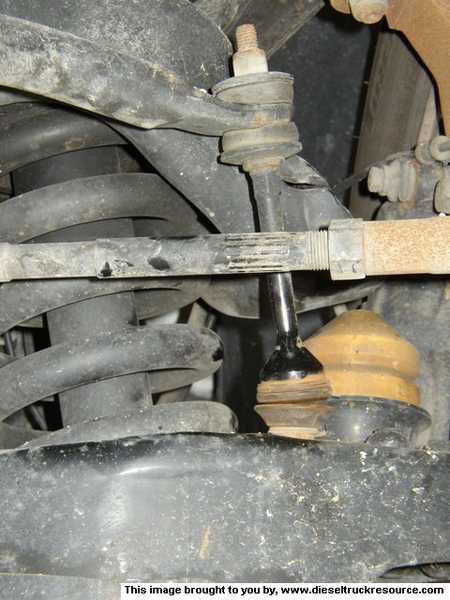

Sway bar end link( the vertical piece)...tighten to 125 #'s torque. I recommend you check the torque specs....I could have the #'s wrong.
Good luck
Whoops!! I didn't read your sig I'm sure you have already put in aftermarket end links w/ your lift, if not they are prolly bent and should be replaced with some "custom" links.
