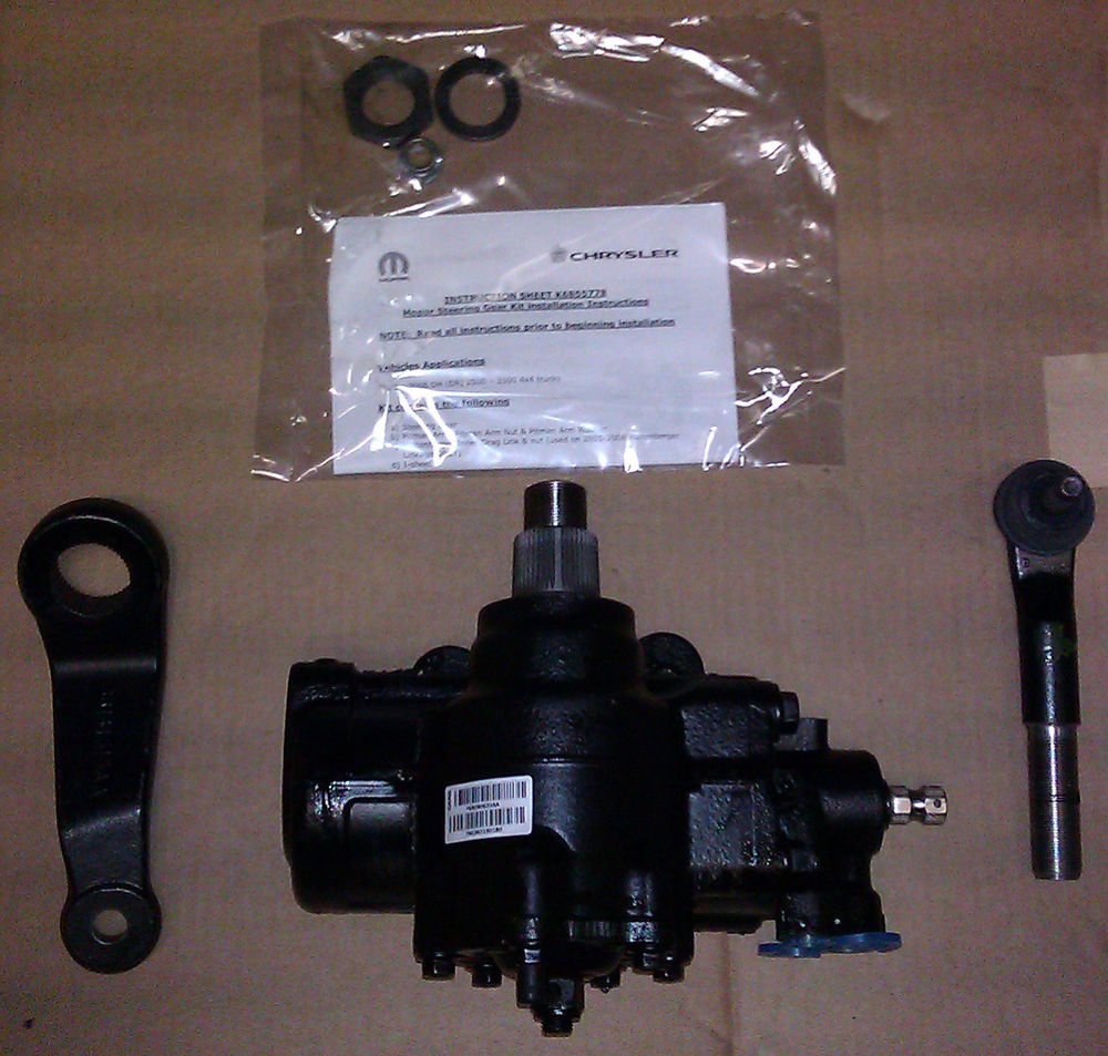

Was the steering gear replaced? New style has no up and down play in pitman gear which cause knocking noise in steering. Easy way to check is take pry bar and lift up on pitman arm using sway bar as pivot point. You will get 1/2 inch of play or more. That play usually will cause nocking noise in steering going over bumps. New gear box will stop that from happening. Or remove gear box and adjust the pitman gear. Care not to get it too tight and make sure you install lock nut to prevent the adjuster from turning if there isn't one there already.

New gear box
If you replace gear box steering wheel will need to be re-centered. Make sure pitman arm is torqued to spec, they tend to loosen if not tightened properly. I have seen several lifted trucks with the pitman arm fallen off.
