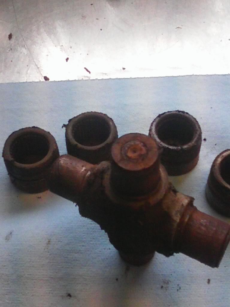

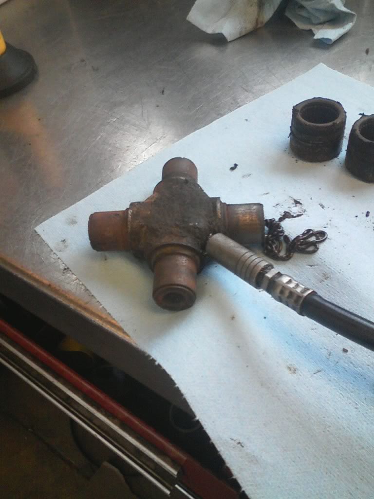

heres a picture I've posted more than once of a precision joint used in my 01 truck that was greased monthly (truck used commercially). just because its greased does not mean that the grease makes it to the cups

grease would only come out of one cup!

the plastic plate has a nossel that gets easily plugged, cant explain how or why they do but they do, I have tried on in a 3rd gen that I drilled it out so the grease would make it to the cups, it did help but the joint failed just over a yr later (in my truck they lasted typically every 8-9months)
