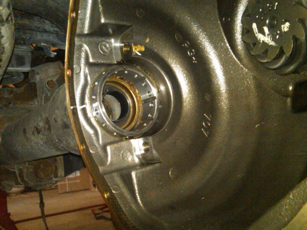

Caution on those Dynatrac spindle bearings, My son-in-law just had one go bad and it took out the spindle and the shaft, his installer years back never told him it was there and that it needs grease every now and then which is a PIA in it self. Cost him some serious cash to fix, he did axle seals while in there, I can get pics of damage if needed.

Get a needle adapter for your grease gun - the longest you can find - lube minimum every 50k miles. The long needle adapter will allow you to it without tearing town the entire spindle to get to the bearing. Just pop off the Warn hub and put needle adapter between out shaft and spindle itself...
This is the inside - you can see what is left of the needle bearings in there.
IMO there should be NO slop in the shaft where it enters the spindle - this is an indicator of trouble coming - speaking from experience - the next sign is that you will hearing and feel like you are driving on rumble strips...it happened to me - yes ,partially self-induced so don't beat me up about it, I paid the price. Just heed the advice if you'd like to.
