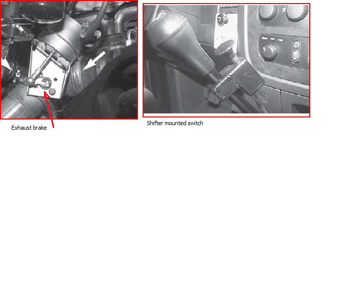

As far as I know, the factory didn't actually install the Jacobs brake. In my case, I ordered it at the dealer who installed it before I took delivery. My pump lasted about 70K miles then quit making vacuum. Rather than replace it with another Jacobs pump with a questionable record, I put on a Pac Brake. Performance is very comparable between the 2.
There should have been a switch mounted on your gear shift lever for the brake. You certainly should have been able to tell if the brake was working.
Since you have identified the pump, I'm attaching a picture of the brake attached to the exhaust manifold and of the shifter switch although that one is on a floor shifter. I suggest you go to the Jacobs web site to download the manual.

Well, go figure, I don't think I have one installed. Sucks the sales lady back in 06 when I bought it even had me take it on a mountain road so I could feel it in action. To tell you the truth I was so worked up about getting a new truck that I most likely imagined it was working?? I looked in the engine bay on the passenger side of the block above the exhaust and did not see anything that looks special. It would be above the elbow just downstream of the turbo, correct?? That's where your pic above looks like to me??

Here is a picture looking down on the passenger side of my engine, it would be visible in this view if I had one??? Do you see one?
