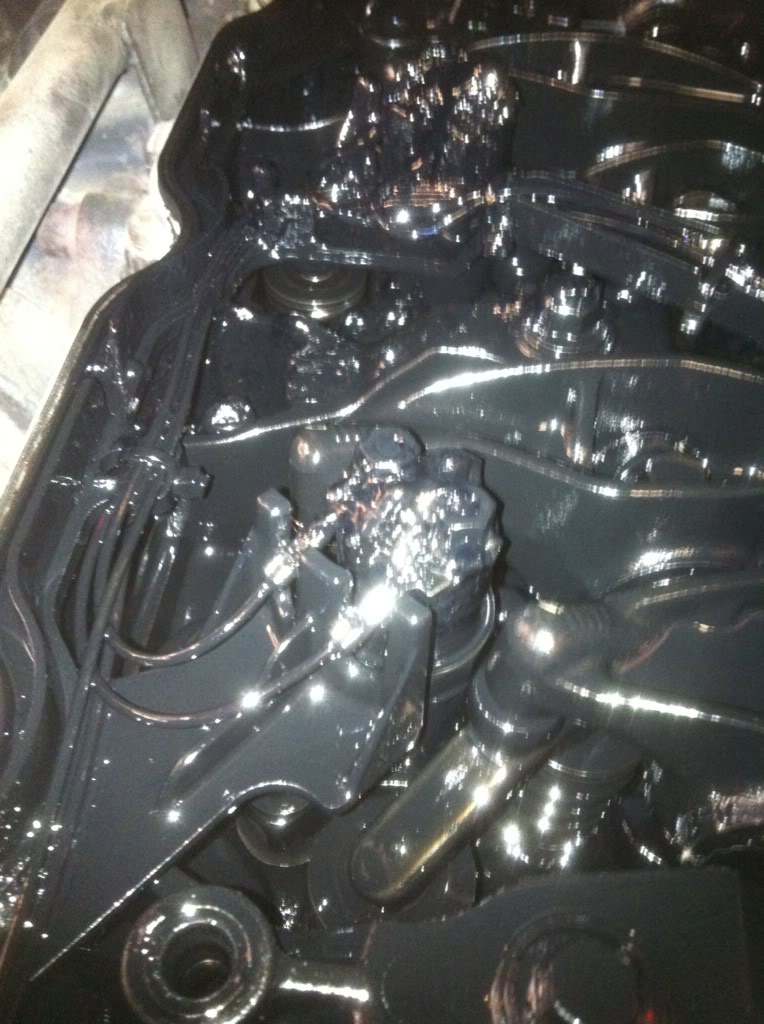

Got a few questions. The wife has an 07 5.9 Megacab Dually. At about 20k we did a bunch of stuff to it: smarty tnt,twins,injectors,cp3,tranny,etc. Has been running awesome, pull horse trailers with it almost every weekend, never had a problem with it getting hot and smoke is very manageable. I was changing the oil with delo 400 every 5k. Truck has 96,000 on it now. About 25k miles ago, I switched to royal purple and have been changing around 12k miles. Well her recently the truck started just running crappy. Hits 1400 on the pyro over nothing, smokes like crazy, super boggy etc. Just running like crap. Changed all filters on the fass, air filter clean etc(do it every 5k miles). Tuned the smarty way down, still gets way hot and smokes like crazy but now even boggier. So take it to Texas Diesel Power who did all the work, told em what was goin on, and after takin it back 4 times(they kept saying it was fine) they finally tore into the engine and found this:Name:  IMG_0252.jpg
The whole top of the engine was just caked in sludge. No wonder it was running bad. My question is, what caused this? Royal Purple?? I wouldn't think so but I did notice that on the first change after I switched, the oil didn't flow like normal oil does. It was really slow to drain, and honestly just kinda nasty. And on the second change it was even worse. Almost like a thick soupy goop. They're flushing the engine, checking all the injectors, and changing the oil and hopefully she'll be running good again. But this really amazed me to see that under there. Any input yall have would be appreciated. Thanks

Wow! I've never seen anything like that on such a new truck. Definitely looks like something is wrong. Let us know how it works out.

Eeew.. Thats not good. I don't know what was in that oil, but its made a mess of that engine. With the other factors you are talking about, I wonder if the piston cooling jets for the engine are plugged off too.
Seems like the oil has broken down, you sure it was diesel rated?
What kind of filter were you using? Why did you switch from good old Delo?

Which Royal Purple oil was used in this engine? Was it the 15W-40 that claims to be CES20081 certified?
If you noted the thicker oil immediately after switching to Royal Purple, it's hard to argue against the Royal Purple being the cause, even if it doesn't seem to make sense.
That said, you *have* radically modified the engine from the oil's perspective. Common rail engines can add a lot of soot to the oil, and EGR engines add a LOT more soot to the oil. When you cranked up the fueling and swapped to bigger injectors that atomize worse, you'll end up with even HIGHER soot levels than before.
What I suspect is happening is that the sooty sludge has been building up a long time, but because your previous oil wasn't able to suspend this oil, it let deposits build up.
Then, you switched to the Royal Purple and got an oil with much higher detergency. The Royal Purple then went to work dissolving all that junk that had built up in the engine, making the RP you drained out thick and nasty.
It's VERY unlikely that this kind of build up occurs in 25K miles of using RP. Far more likely that you have 96K miles worth of sludge in there that previous oils couldn't manage.
I'd recommend that you switch back to a petroleum oil like Rotella briefly and do some short drain intervals to try and clean things out a little. In conjunction with this, I highly recommend a product I've had excellent results with (which I discovered over on bobistheoilguy). Lube Control LC20. http://www.lcdinc.com/products_lube_control.php I noticed that this stuff really turns new oil dark fast as is clean out all the crud. Fortunately, it doesn't flush it out all at once, but rather it seems to "melt" all the junk out.
So I'd do a couple short intervals of dino oil + LC20 until the engine looks cleaner inside, then switch to whatever oil you want to use.
EGR engines are very hard on oil. Make sure you use a CJ-4 rated oil as they do a much better job managing soot and avoiding deposits. Ignore the myth-- CJ-4 oils are better in every way that matters.

I have seen that before, I took oil sample and it came back that Anti-Freeze mixed with the oil. some how anti-freeze and oil make it really thick.

Several things come to mind:
Engine not getting to operating temp (thermostat), regardless of Pyrometer
Short trips
Clogged crankcase breather(s)
Oil contamination
Incorrect lubricant
If this just happened, I'd send out and oil sample for analysis. I mechanically ok, replace filter, run some light weight oil to flush out the system. Drop the filter and use what you were using before.

Coolant mixed with oil tend to make it thick, but also milky. I can't tell from the pic if it appears milky.
If it is milky, and it is caused by coolant contamination, then your engine is very, very sick. Mostly like a major casting like head or bloc (read: $$$).

My biggest fear would be the oil pickup screen becoming restricted and starving the engine of oil before this mess is all cleaned up. It may be worth adding a live oil pressure gauge, at least temporarily.

Wow lots of info to answer back to here so not even gonna try. A couple things though. I don't think its antifreeze in the oil. Its not milky or anything like that. As far as operating temps, my wife drives this truck 99% of the time, but 90% of the time the truck is allowed to sit and warm up. My wife is kinda bad about jumping in, starting it and going, but I've worked on her about it, and shes gotten pretty good about letting it warm up at least a little while, and then driving it easy until its all the way warm. I don't really know why I switched to royal purple. I've always run dello and never had a single problem, but I've just heard a lot of good stuff about RP, and figured I'd give it a shot, and put it in both her's and my trucks. I'm not really one for going 10-15k on an oil change though, so I went back to dello on mine, and am gonna do the same on hers now, and go back to 5k mile change intervals. Always use cummins fleetguard stratapore filters. Havn't heard back from Texas Diesel Power yet, but last I heard they said it was an overfueling problem, which makes sense to me cause this would mean much more soot, which would mix and make the sludge. But last I heard, they were flushing the engine, changing oil/filter, and cleaning and pop testing all the injectors. I'll let yall know when I hear something back. Should be monday, but I may hollar at John this weekend and see if he's found anything out.
