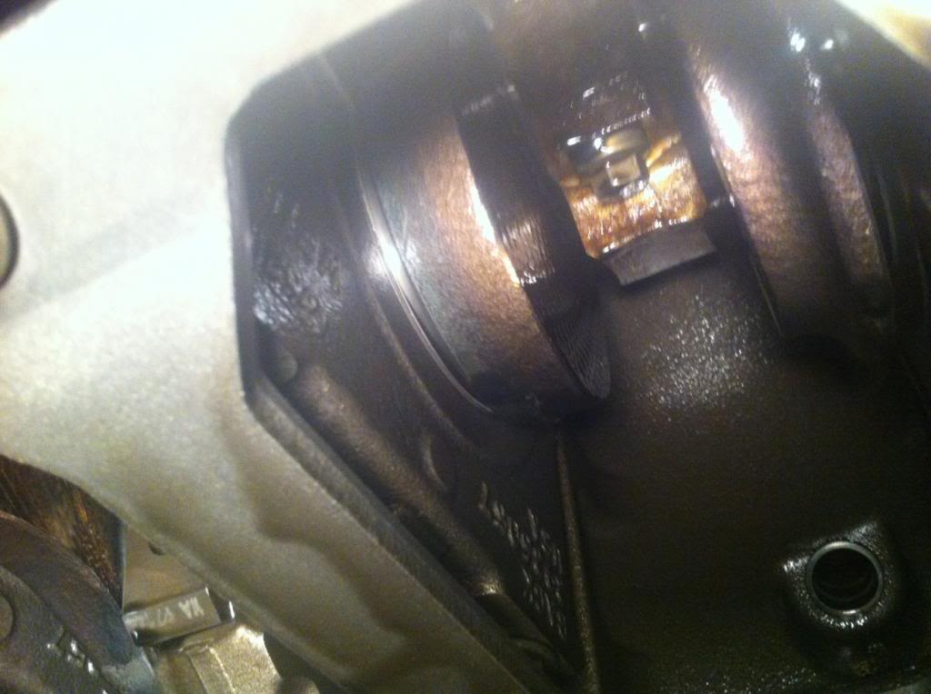

So I pulled the pan. Crank still won't turn at all btw. Anybody wanna point out the ugly in these pictures?
So exactly how again do bearings seize solid with a pan full of oil? Anybody heard of a Cummins oil pump failing? It still puzzles me how the bearing particles got into the piston bowls, I wouldn't think they would get past the rings and that should be the only place oil enters the combustion chamber. Unless that material comes from the valve guides? Head looked well oiled. I'm confused on that one . . . .
Oh, and if I didn't mention already, I had an oil analysis done just 'cause at the last oil change--9500 kms on the oil and for wear metals I had 16ppm iron, 1ppm Al, 2ppm Cu, zero across the board on all other wear metals. Not exactly indicative of an upcoming catastrophe.

The oil pickup tube could have gotten loose and was getting air into the pump. The pump almost never fails. With only a 6psi switch and the computer telling you that you have oil pressure, the pressure could have dropped and you would not know it without a real gauge.

***! Its like it seized for no reason. What does the turbo look like? That is the only way I could see getting metal into the bowl of the piston.
Old Feb 22, 2013 | 06:35 AM
Hintonc393's Avatar
Joined: Jul 2011
Posts: 269
From: Knoxville TN ya'll
Wouldn't hurt to check the thrust bearings.
Old Feb 22, 2013 | 08:14 AM
BigIron70's Avatar
Cummins Guru
Posts: 4,191
Likes: 65
I would also check oil pressure relief valve and oil galley plugs to see if the galley plug came out or relief valve spring or valve is problem with lack of oil pressure. Do you use Fram oil filter? Known to cause problems. Cut the filter open carefully check if filter has come apart. I had to replace several engines because customers were using Fram filter. Filter material plugs the J nozzles causing pistons to seize and scored cylinder walls. I can see that in your photo, scored cylinder walls. First thing Chrysler asks "what make filter is on engine" Filters are not the same inside watch video.
