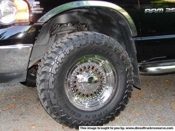

[IMG][/IMG]
e range. rarely rub. not too loud. wear seems to be ok. wow in the mud.

Do they rub because you have aftermarket rims with different backspacing though? I've never heard of them rubbing before on a stock truck.
ITS BECAUSE OF THE AFTERMARKET AFFSET AND BACKSPACING. I HAVE 315/70/17'S BFG AT'S ON STOCK RIMS. NO LEVELING KIT AND NO RUB. AS SOON AS I MOUNTED THEM ON AFTERMARKET RIMS, AND MOUNTED ON THE TRUCK, THEY WERE HITTING BOTH FRONT AND AFT OF CENTERLINE OF HUB.

yes aftermarket backspacing and wider wheels.
