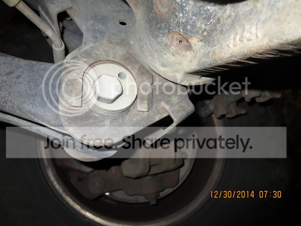

Change the caster setting... Loosen both the eccentric caster cam bolts and turn the cams so that the passenger side control arm pointer arrow stamped on the side of the cam is pointing in the 9 o'clock position, towards the front of the truck. The drivers side will follow because the axle is solid, but you will have to make sure to have it pointing in the 10 - 11 o'clock position. They're not the same because of the cross caster pre-built in the axle housing.
When they're positioned like described, tighten the cam bolts back up and take it for a drive. I bet you find the steering to be immensely better...
Why this works is because the 2nd gen Dodge Ram needs more positive caster than the OEM alignment specs allow for. Then adding any amount of lift will push the caster in the negative direction and make the alignment even worse. Caster positioned with not enough positive angle will cause poor steering feedback and twitchy steering. Thats where the DW comes from.

Thank you, I have been asking everywhere, no one has given me any positive help. I will do that today.

I'm still fighting this truck. I put the 09 updated tie rod drag link assembly on, had the alignment done and drew a picture of caster they attached to the work order, set it at 4.2 to 4.6 positive per Rough Country, it helped. at 70 MPH hit 3 bumps in a row the truck will start bouncing, I took it to another alignment shop they printed the before, it was at 2.5 positive caster, they got it at 4.3 left, 4.5 right. much better.
I have done everything that I have read and what the engineer at Rough Country said, it is down to the springs or tires, it feels like the left front starts the bounce, I have had all the tires put on that corner, balanced 3 times.
today I'm going to the shop and turn the adjustable bottom control arm out 2 turns t give it more positive caster. if that don't fix it I'm trading it in or try to move a oak tree.

I guess I got it, I did put the tires up to 75 PSI and I turned the bottom control arms 2 turns, I drove it over some bumps at 70 MPH and no bounce, My kid took it north highway and city driving, hit several bumps at 80 MPH
