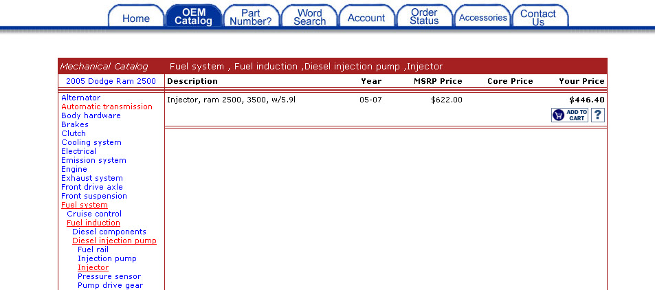

Originally Posted by yepuhuh
Picking it up from that Dealer and taking it for a second opinion.
injector pump 2230.00
injectors 4668.00
lift pump 382.00
The 24year disel mechanic i talked to said, he would only take out the fuel tank first to see what is in there for contamination..... Then go from there.
oh and labor 1735.50
and little items like shop supplies, etc
This site https://www.dodgeparts.com/oe_parts_catalog.html quotes them
for $446.40.
Attached Thumbnails Dealer stealing going on here 9,753.00 repair bill?????-injector-price.jpg
